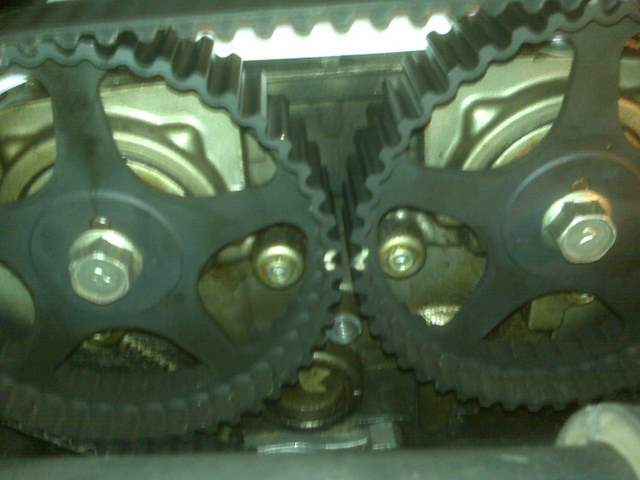

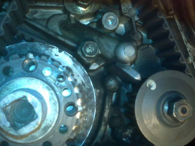

Finally figured out my problem:
I ended up having to redo the timing belt myself... The mechanic that did the original timing belt work screwed up and didn't pretension the timing belt correctly. The auto tensioner was unable to take up enough slack and the belt slipped quite a bit... Needless to say, I've since fired that mechanic..

Wow the timming mark on the crank is way off huh ? You should do a complaint to the garage that did the work.
