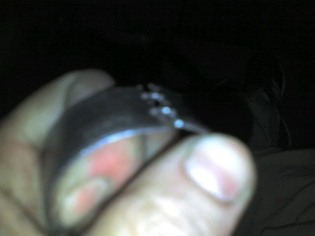

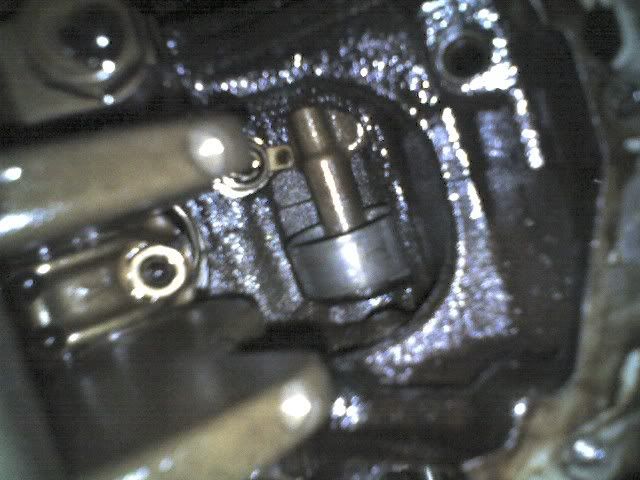

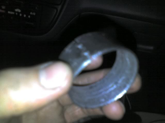

You are absolutly right my man!
after thinking the front balance shaft was 180 out, I took the balancer belt off and noticed a slight amount of play in the front sprocket for the balance shaft. I have over $100 worth of parts coming to do the eliminator kit. I'm thinking with the car being drivin and the balance shaft out of whack it screwed up the bearing(s).
Second thought just for a piece of mine I pulled the rear plug off of the backside of the block and noticed the plug was too long and the tip had been ground off a little by the balance shaft! so I made it shorter and put it back in.
I'm hoping that this eliminator kit not just solves my problem but isn't that much of a P.I.T.A. to do. Anyone know how to drop the motor down a bit to have the front balance shaft clear the frame? I know removing the crossmember and disconnecting the driveline and x-fer case may allow a little extra play but whats the easiest way to do it?

so after taking everything apart, the bearing on the front balance shaft was out of its seat and just hanging on the shaft in the middle of nowhere. God I'm lucky. The only thing vfaq didnt touch on was removing the alternator. All I have left to do is pull the shafts out, waiting for parts to get here, should be here wednesday from extremepsi.
overall not that difficult to do.
