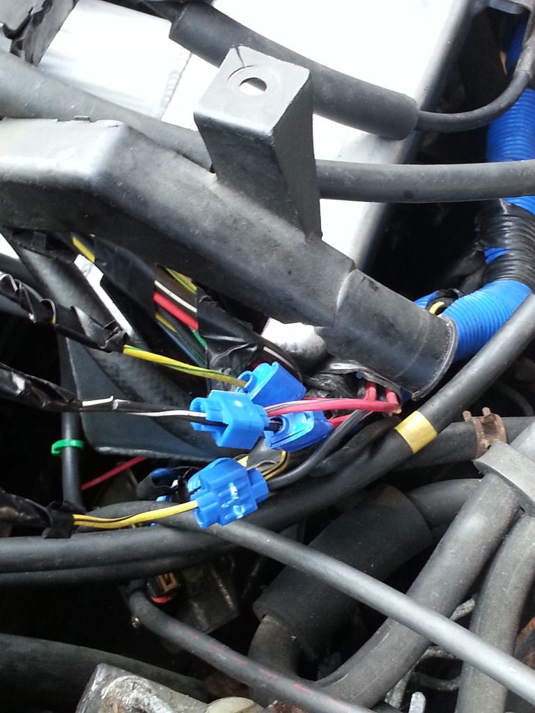

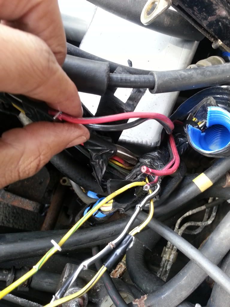

So think i found my problem. Those 2 red and black wires that go to my coilpack are torn, idk how but they are. Never really tried soldering wires before so i guess ill be trying that this weekand

Who did that, I will get them! Seriously, WTF is going on with that harness. Why are those stupid crimp lock ghetto connectors on some of the wires?
You may have a hard time soldering those wires. They are going to be dirty (the copper) And the solder will have a hard time sticking, even with flux. If you have any quality part stores or Radio Shack, I would see if they have butt connectors with the heat shrink weather tight stuff on them. Then pick up a decent pair of crimpers and attach them that way. Clean up that other crap and make sure the wires get covered.

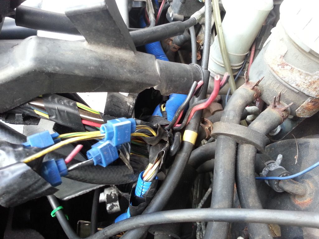

So I've bought new clamps, and put the yellows/green wires with the black, and the red wires both into that black/white wire. Still no spark.

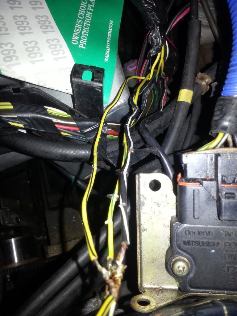

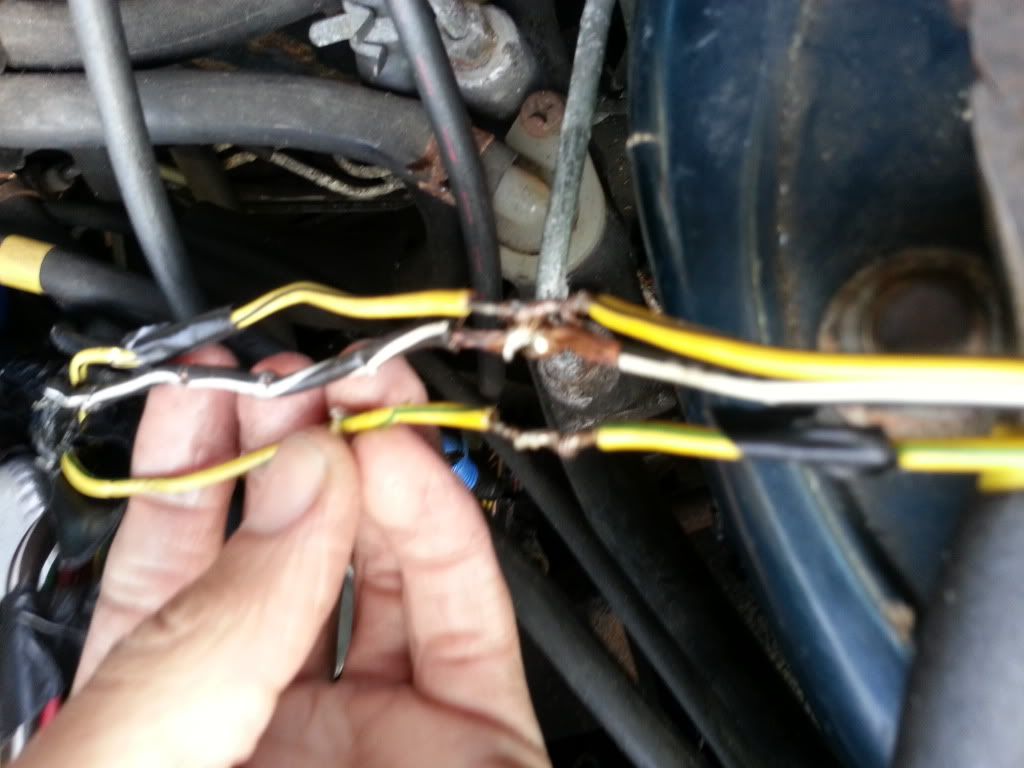

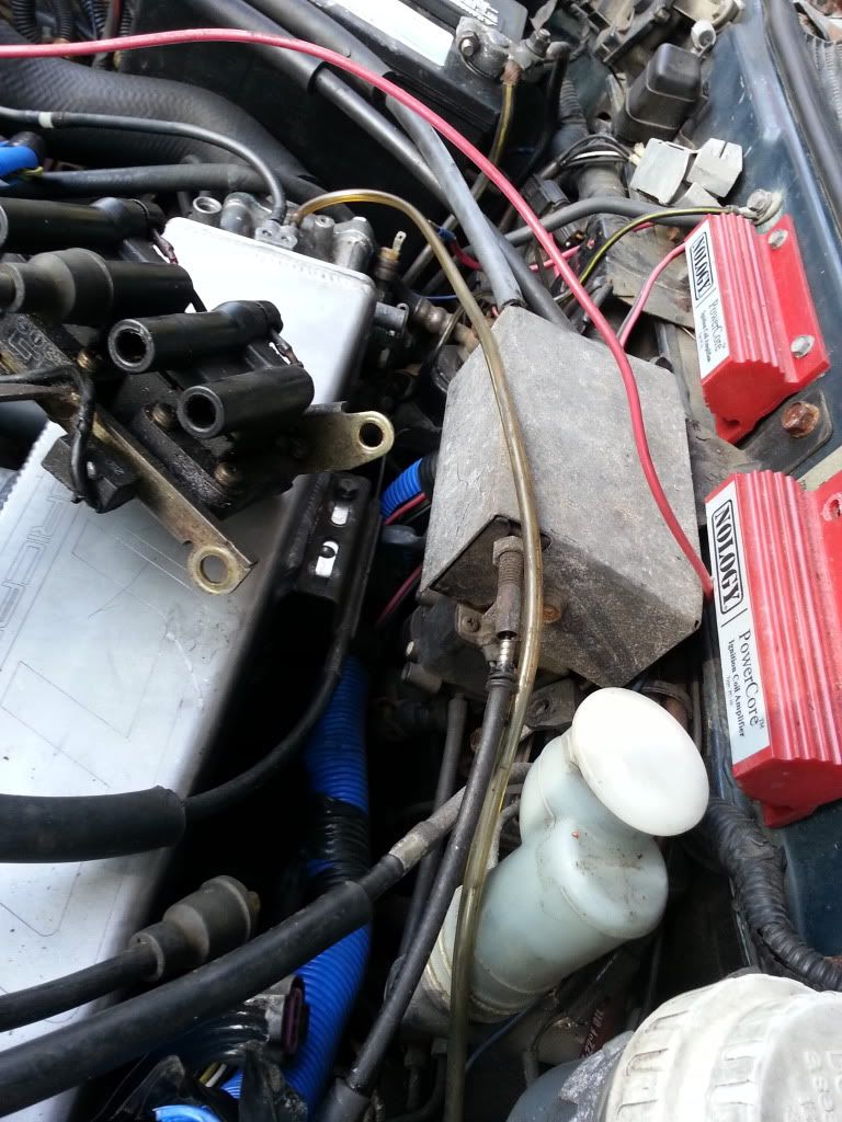

Ok, here's what i got. The yellow/black , yellow/green , black/white wires are from my coilpack connecter. The 2 red and red/black wires are from the nology ampfliers, checked Google and the wires colors dont match. http://www.nology.com/images/powercoreinsteclipse.gif.
But this is pretty much what it looks like with all the duck rape removed.

Have you tried not connecting your amps, having the wiring stock to see if the car fires? Not sure if I've seen you say that you've tried to get the car running with the stock components?

The coil plug should come from the injector area, shouldn't it? I would try and verify the transistor wiring is unmolested, and run to a junkyard and get that plug, cut as far back on the harness that you can. Note it's location and install that instead.
