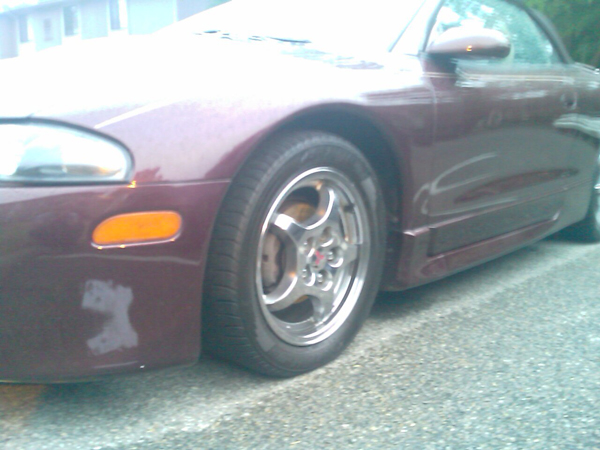

Picked the car up for ~$3,250 off of craigslist. The PO had lowered it on Tokico Blues and Tokico springs. Aside from that it was bone stock.

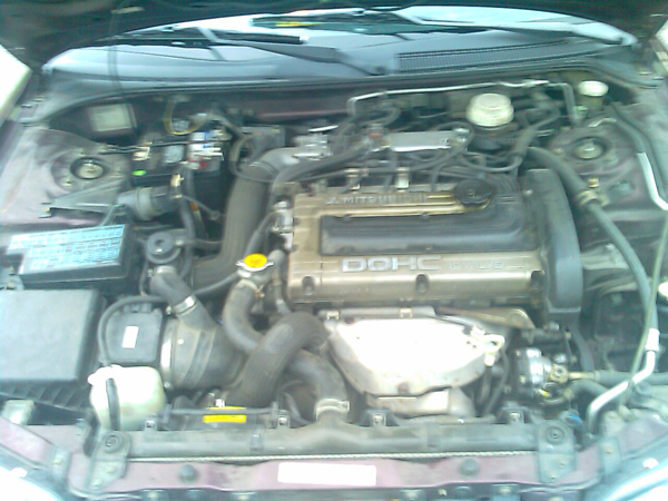

Finally home. Pulled a few things apart for further inspection.

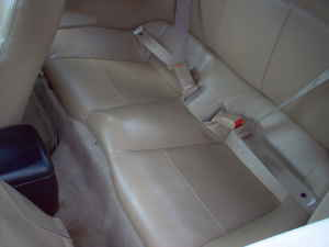

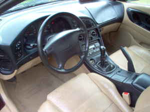

The seats were pretty ratty, so I picked up a set from Summit. I also threw in some new plugs, drivers motor mount and AC fan.

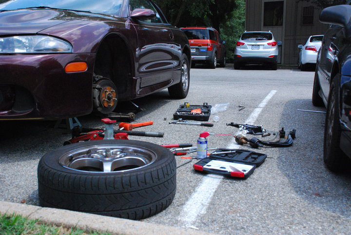

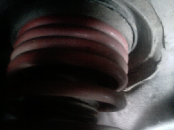

Tokico springs looking like jelly bands. Something went wrong here. I couldn't find any burn marks from heating the springs. They weren't cut either. This destroyed the control arms. New arms and Eibach Sportlines went in.

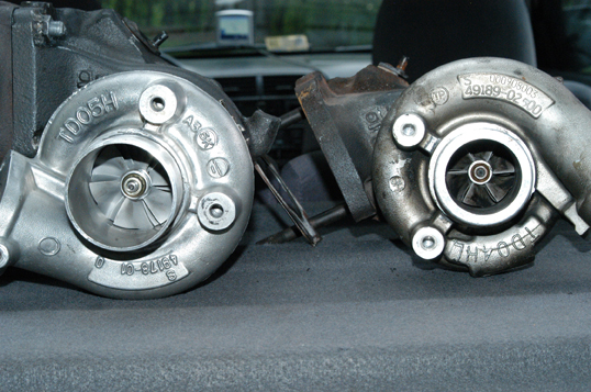

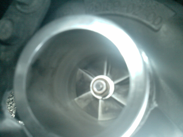

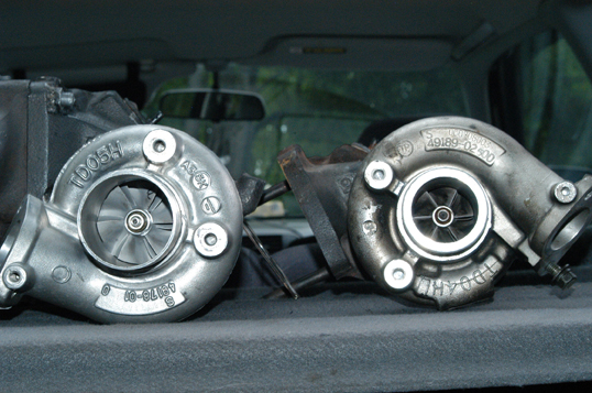

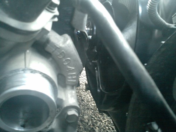

Much confusion over this tiny little guy. The engine is from a Mitsubishi RVR from over in j-spec country. The debate rises with the compressor wheel. When it came time to pull the turbo, I put the myths to rest in discovering the TD04HL is in fact a 13T turbo, a slightly larger variant of the 13G.
