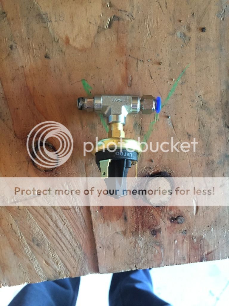

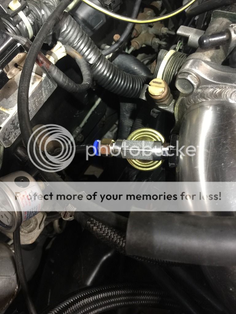

Set up meth injection through link, then build a fail safe. Pumps kicks on and starts spraying at 1.9 load which turn out to be about 17psi, fluid flows, once my pressure switch sees 12psi inline before the nozzle, then grounds out my TPS switch in turn engaging my AUX map(meth map).

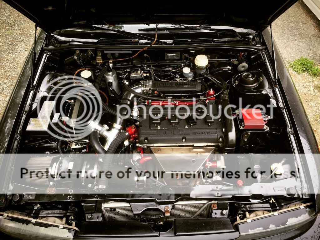

Don't judge the dirty bay... I haven't did my spring cleaning after the winter as I'm moving back to Florida end of summer. Exterior still cleans up nicely for a turd!
**I cheated with black quick detailer. Shh
