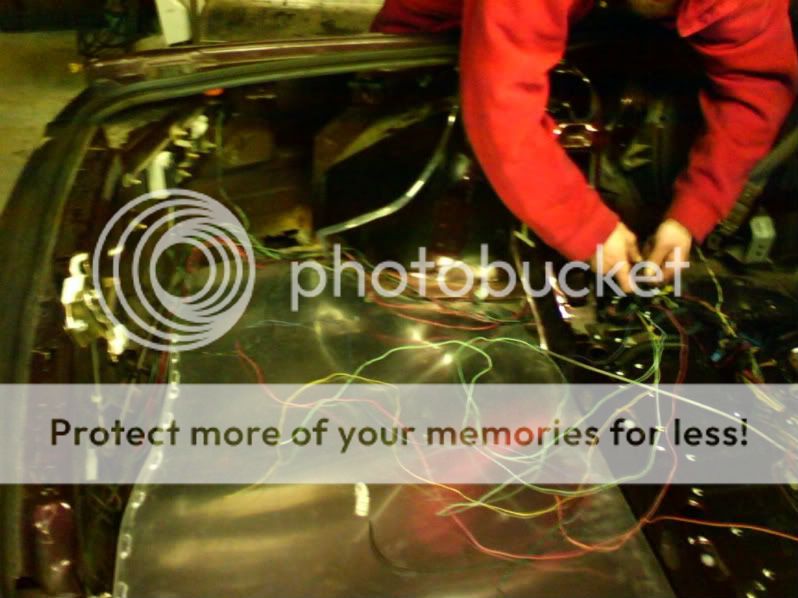

Lets do some wires tucking. ;)

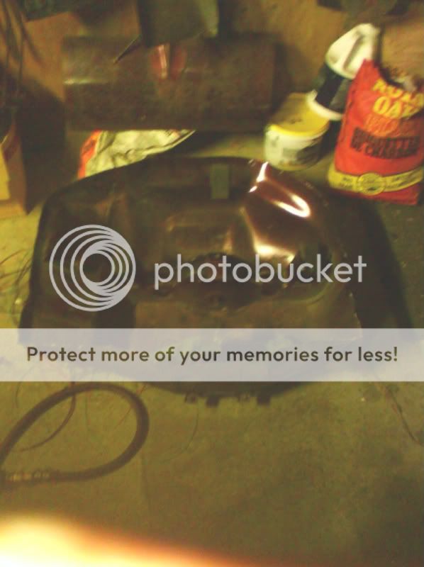

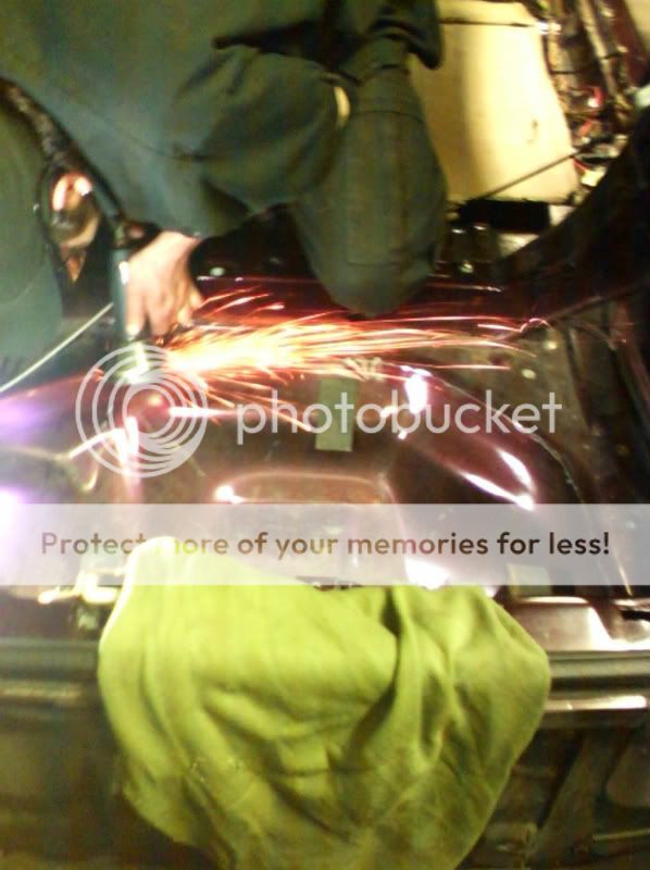

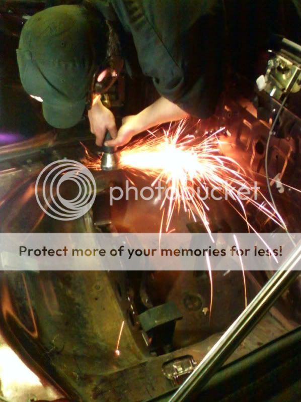

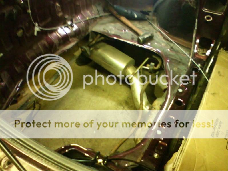

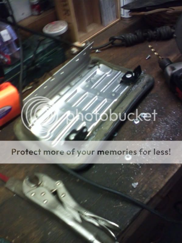

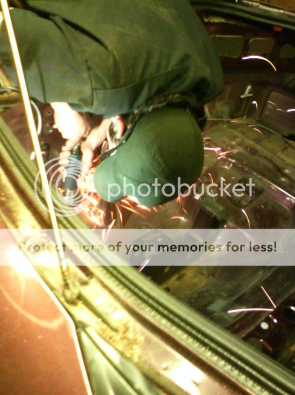

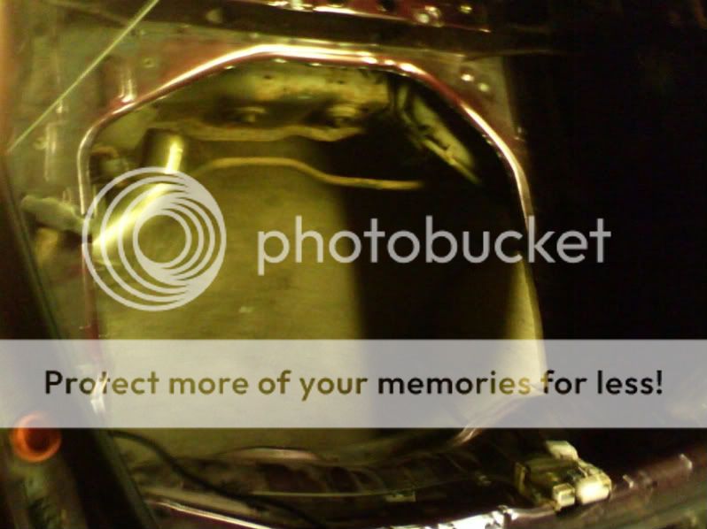

Well I decided to cut the floor in the hatch and fab a new floor to put my battery box. It also save weight, remove 18 lbs and my new flor is 2.5 lbs. :cool:
Better be safe when you cut this floor ! ;) Don't forget to watch the gaz filler hose that pass near where I had to cut ...
4,637 Posts
So how did you weld the new floor to the back part of the hatch? Did you bend it up and weld or rivet?
It looks cool, I guess but to save 16lbs, meh. Not worth it IMO.

I was gonna do the same to my GVR4, but becuase of the contours on the VR4 trunk, I decided against it.
Looking good.
I will use rivets to hold the new floor since it's in aluminium ... Well 16 lbs is not bad at all I think and it also looks awesome with the battery box on it. ;)

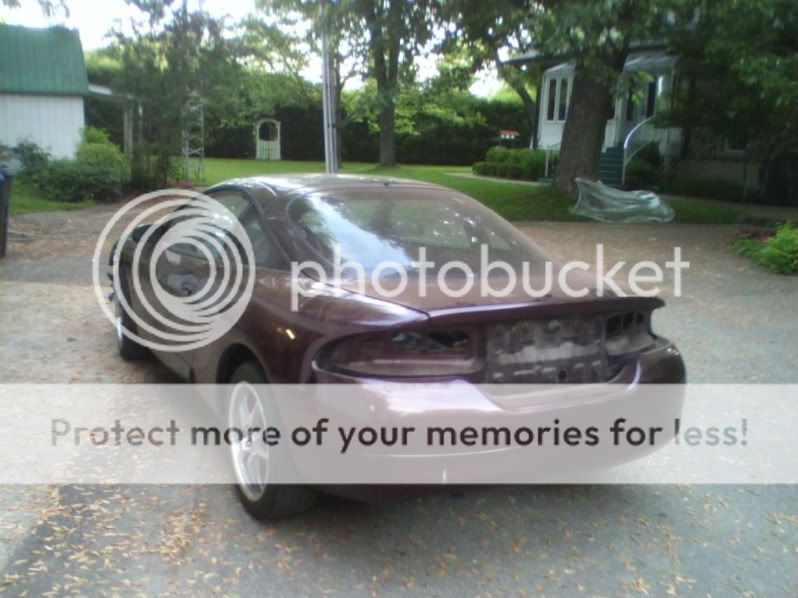

The car will have a new exterior and interior paint and some serious body work. I don't really know when I'll be done with this project but it's going on it's way. :rolleyes:
The story of my DSM:
I got the car 3 years ago with 90 000 miles on it. The car was bone stock and not really good looking ... Well not good looking at all. :eek:

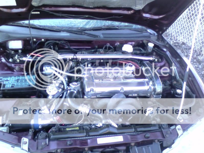

Ok I finaly find the time to do a list of all the mods I have done since I bought the car. All these parts where installed before I start the build. :D
DSM4LIFE-AWD Current Mods:
Engine:
- Stock 2.0L 4G63T 7 bolts
- Balance shafts
- Turbo 16g Evo III
- NGK BPR7ES spark plugs 0.028“ Gap
- Magnecore KV85 Spark Wire
- Hallman Pro RX Boost Controller
- Greddy Oil Catch Can on Valve Cover Pressure
- Custom Catch Can on pcv valve
- SS Exhaust Manifold Studs
- EGR Block-Off Plate
Intake:
- 2G MAF
- Ebay Intake Hard Pipe + Filter
- SSAutoChrome FMIC
- Ebay Type RS Blow Off Valve + Return Kit
Exhaust:
- PaceSetter Exhaust Manifold
- SSAutoChrome External Dump o2 Housing
- Megan Racing 2.5” to 3” Down-Pipe
- N1 3" Cat-Back Exhaust
Electronics:
- GlowShift Boost Gauge 30-0-30
- GlowShift Oil pressure gauge
- GlowShift Oil temp gauge
- GlowShift Water temp gauge
- GlowShift A/F Disco Light
- Innovatek 4303 Radio
- Greddy Turbo Timer
- MTX Distribution block + In line Fuse
Fuel System:
- Fuel Pump Rewire, 8ga feed wire
Suspension:
- Tokico HP Struts + Coils
- Front/Rear Upper Strut Bar
- DAI Chaos 17”x 7” 42mm Offset
- 215/45/ZR17 Wanli tires
- Energy Suspension Polyurethane Rear Suspension Bushings Kit
- Ingualls Rear Camber kit
Transmission:
- Fidanza Flywheel
- Stage2 Clutch XTR
- Ebay B&M Short Shifter
- SS clutch line
- Slave Restrictor Removed
- Shifter Base Metal Bushings
- Shifter Cable Metal Bushings
- Clutch Switch Disconnected
Interior:
- Mount Pillar Gauge
- Mount Center Gauge
Other stuff ... :
- Shaved and Polish Valve Cover
- Hayame Chrome Plug Cover
- Hayame Chrome Oil Cap
- HID Bulb High/Low Beam
- Clear Side Marker
- Clear Cam-Gear Cover
- Non-Cruise Throttle Cable
