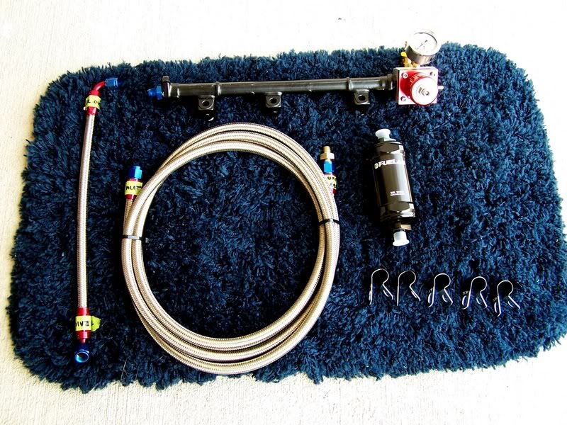

Ok well today me and my mechanic were changing my Fuel line and my mechanic think I have chosen a wrong fuel line size ... :eek:
Walbro 255 lph
From the pump to fuel filter: -8 An
Filter is Aeromotive 10 micron : -8 An to -10 An
Filter to Fuel Rail : -8 An
AEM Fuel Rail
Fuel Rail to FPR : -8 An
FPR to gaz tank : -6 An
He said to me search but I think you need a -6 An line from the pump to Fuel Filter , -6 An line from Fuel Filter to Fuel Rail, -8 An from fuel rail to FPR, and -6 An return line ... :(
wich setup is the best ? :confused: :huh:
Im running Evo III, FMIC, 650cc with DSM Link ... Going to uprade turbo in the futur so I tought that -8 An would be the best choice ???
Thanks for your help and reply your opinion !

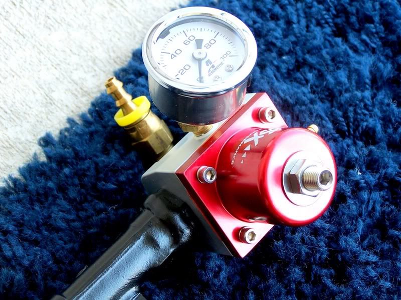

FFWD High Flow Kit (Just to add a little something to look at)

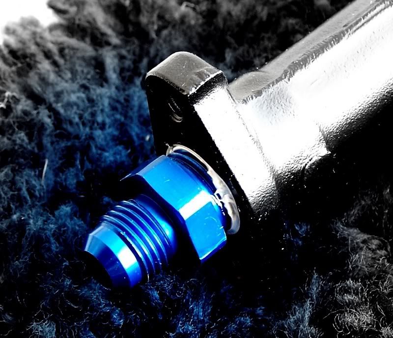

Thats kind of a good picture, I never though about threading a 3/8 or 1/2" x -6an adapter into the fuel rail, would efinately eliminate the possible leak of the fuel rail adapter.
