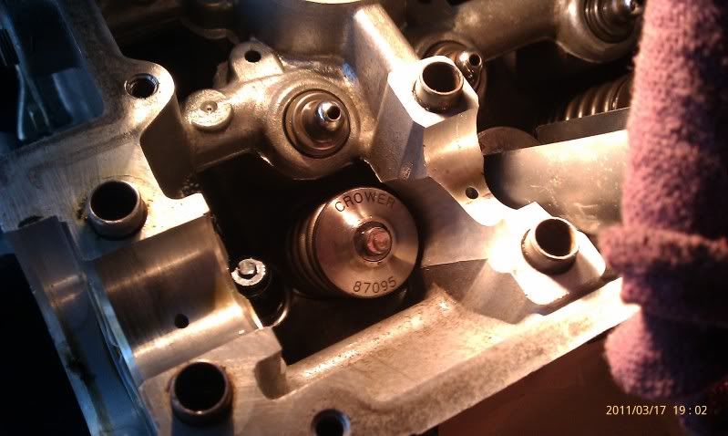

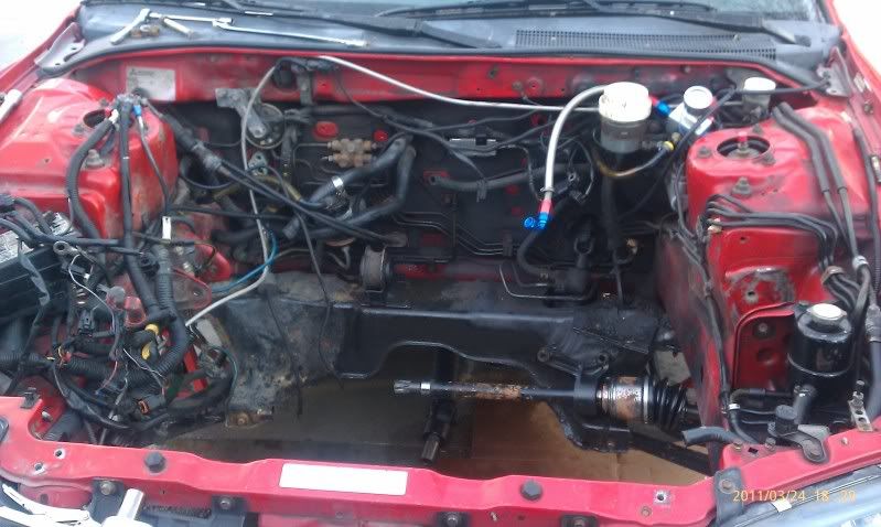

I haven't posted many pictures of the car since I installed a lot of my mods. Here are moAr pics!
NOTE: These pics are not updated and do not reflect my updated mod list.

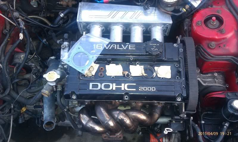

I hope you cleaned that shit up before you put that shit back together... And also hid some of those wires...
And I hope you mounted that AFPR too!
:D I knowz.
And I approve. Unlike that queer MacGSX. :p
I know what he is doing... But I hope he is doing it right!
Okay, the bay isn't as clean as I'd like it to be. It was cleaned, and will be cleaned more once everything is in.
I figure I'll throw in another teaser or 2...
One of my favorite 2gbs on this site (after mine that is). Just kidding good work. =]
I couldn't remember if you said you were keeping that DNP, but just a heads up unless it's rewelded/checked, it's going to crack on you. Even the DNP's crack, just not as fast as the eGay's.
But, knowing you, you wouldn't half-ass anything. Looks great man, can't wait to hear the numbers!! ;)
That engine and intake looks familiar.
^^It would seem that a certain clear cover is missing??^^
Its there, just polished up so good that it looks invisible.
