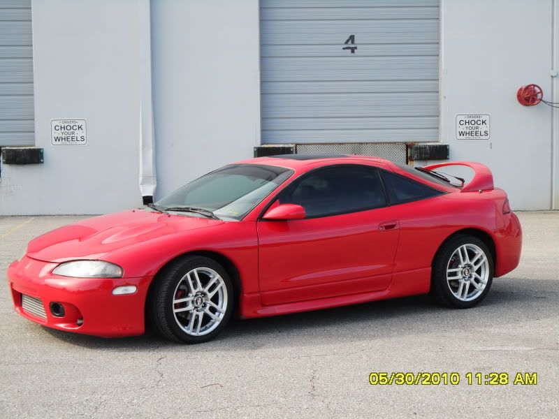

It's about time I made a thread in regards to my car. I finally decided to get her all cleaned up and take some pictures. I've had my car since November of 2004. This car turned me into a complete DIYer. She has come a long way since I first got a hold of her. I bought her with 70,010 miles out of Connecticut.

I haven't posted many pictures of the car since I installed a lot of my mods. Here are moAr pics!
NOTE: These pics are not updated and do not reflect my updated mod list.
