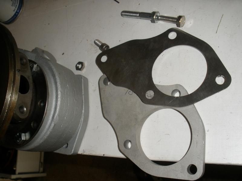

I hit another little roadblock, from putting the car on hold. I’m looking for this part.
Shane (spoolin69) made it for me, it was a custom part and now I need it to complete my turbo build. Its a flange and gasket that bolt to the turbine housing allowing me to make the o2 to downpipe section of the exhaust.
I’m ready to move forward and can’t find it. Getting nervous.

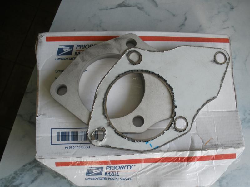

I think that I have another flange and gasket in my basement, I will check tonight.
Have you received your package??
3
Thanks!
My gift from Shane.
After unboxing the awesome S.S. flange & gasket I went to work on getting the turbo on this car.

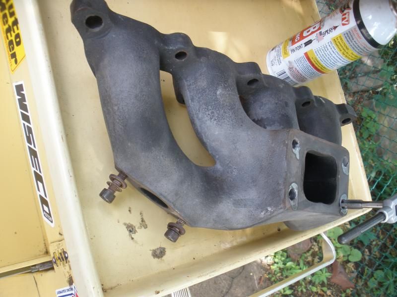

I got lucky and found my Turbonetics cast t3 manifold. Got it cleaned up by tapping the threads, put anti-seize in the holes...
Then realized I don't have any bolts to mount the turbine housing to the manifold. Without this I can't really set the height to mock up the oil drain line or the o2 housing. That would be if I could find the whole 02 housing I used to have. I spent all of Saturday and part of Sunday looking for it.
Wherever it is I bet its right next to the original spoolin’ flange. I don’t know where this stuff walked off to.
So right now this is where I’m at until I can locate more of my stuff.
