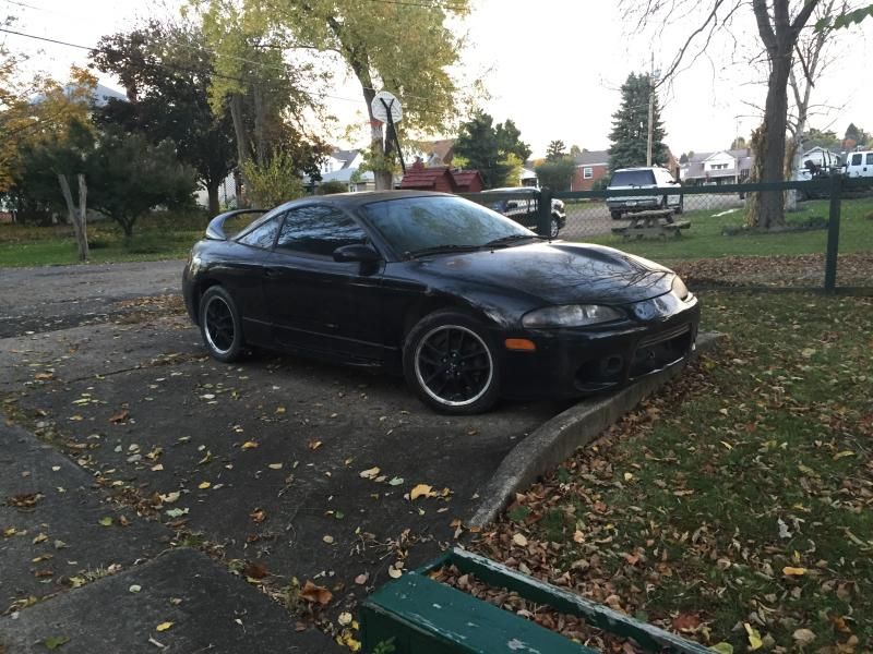

My talon needs some serious rust repair from my neglect and laziness. I'll get to it, but I'm just too busy to restore it the way I want right now. So I'll drive / auto-x this new one. At least that is the plan.
Not as stock as I was told.
Paid for it,
I'll get the title another time.
It wasn't in as great shape as I was wishing. But it was running, I didn't try to move it, was told it needs a new trans. I'll see, hopefully its something simple. It had an unrecirced BOV on the 2g maf and a boost controller.... Its best the transmission went before the motor.

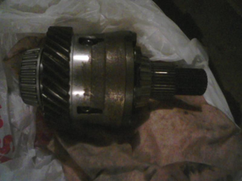

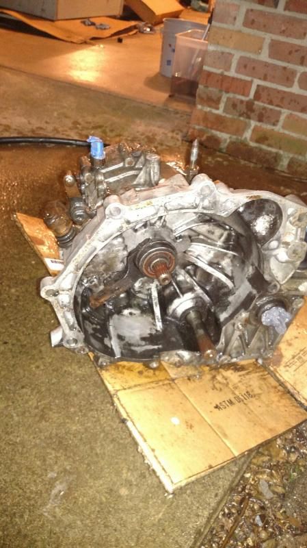

Got the trans and clutch out of the talon tonight, I'm thinking of opening it up and putting my 4 spider diff into it. Might freshen up the axle seals while I'm at it.
Time to ask around to pick some OG brains.
Are the seals easy enough to replace while its open? Order them from Jacks?

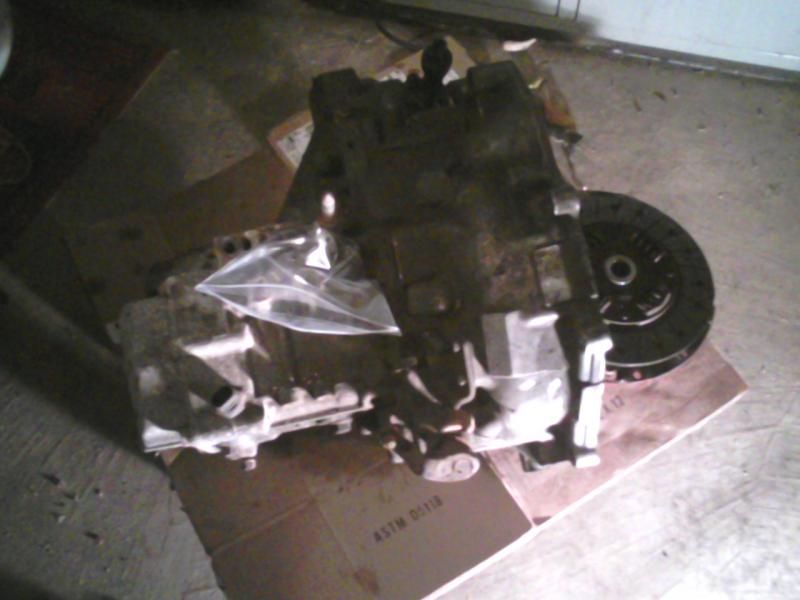

4

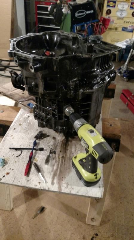

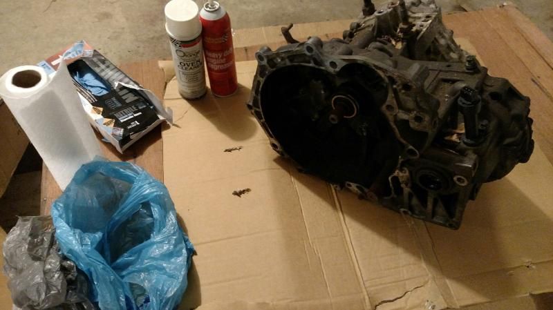

The transmission was absolutely filthy and grimey, I needed to clean it up.
I used degreaser, a wire brush, some scotch brite and oven cleaner.
Nope that isn't black paint, thats how nasty greasy it was.
I would clean for a bit then rinse it off with the hose. I wouldn't let the oven cleaner sit on the aluminum for more than a couple minutes at a time, it will damage the aluminum.
This is where I left it. I couldn't keep going, it started seeming like i wasn't making progress so tomorrow I'll pick back up.
I ordered some paint from eastwood so I'll need clean enough to paint.
My eastwood stuff showed up. This is the paint I plan on using once I wipe the whole thing down with PRE.

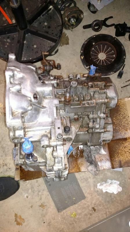

Making good progress. If you have a pressure washer (or can borrow one), they do an excellent job of getting the nooks and crannies on trannies.

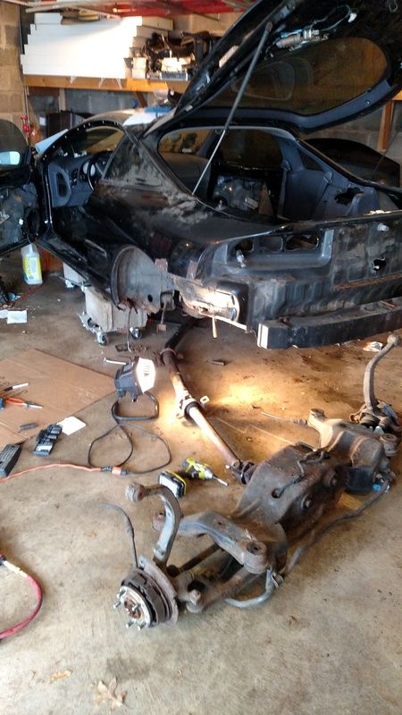

3

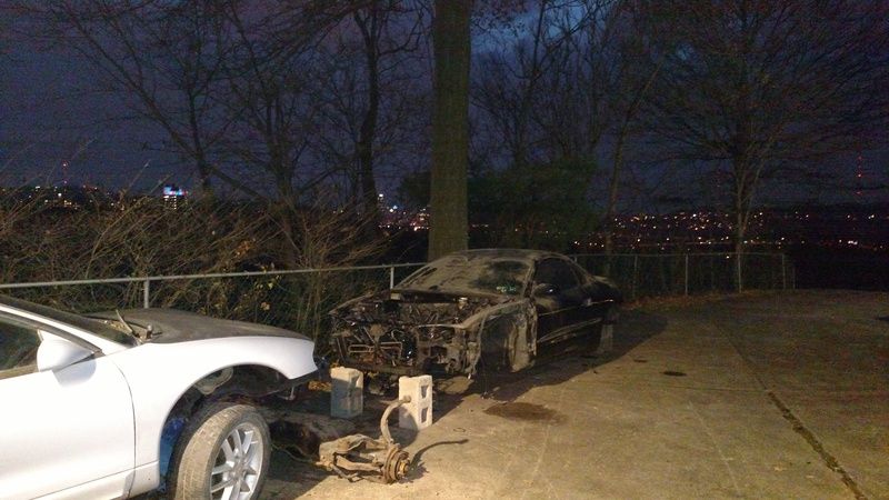

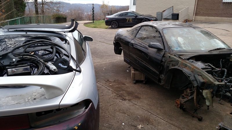

Her story might be over, but her parts are going to live on in a rust free Shell that Is the silver car....
The talon was rusty when I got it, I'm lucky I got as long as I did out of it.
