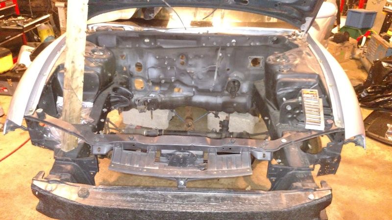

New chapter, all the best parts will go on this rust free Shell.
BTW better buy stock in Eastwood! Because I'm going to use just about every "snake oil" coating they sell trying to seal this thing up so it doesn't rot like the last one.
I'm going to use as many parts from the talon as reasonable, to see it's memory live on in this ride.

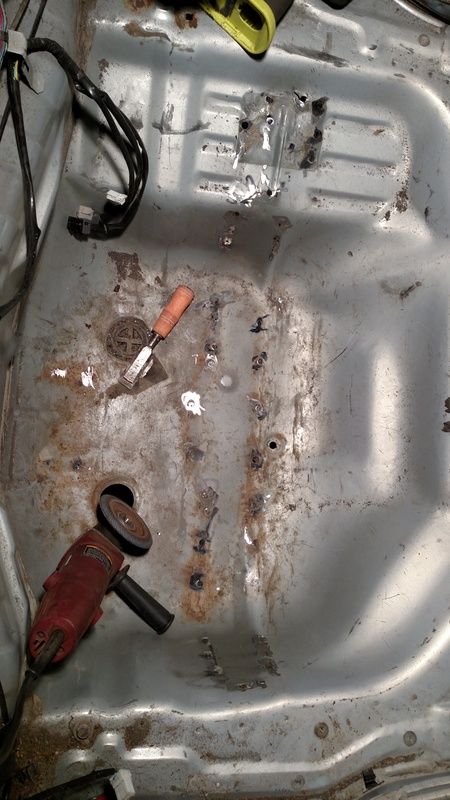

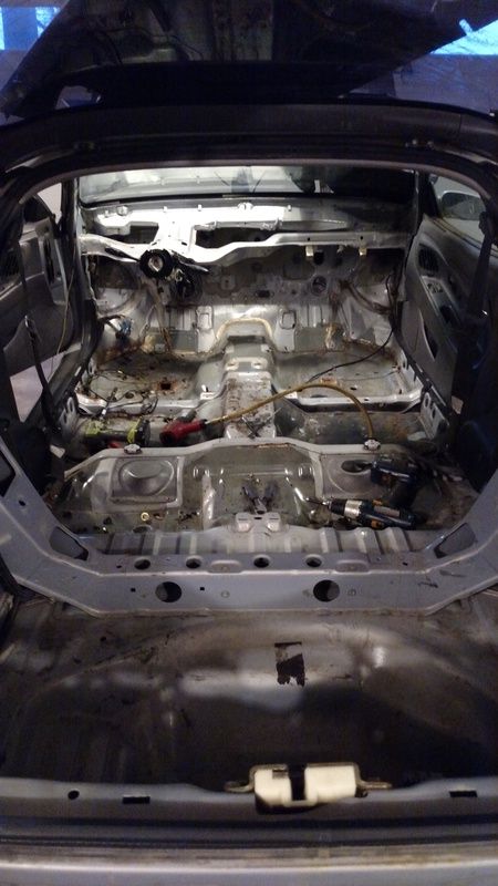

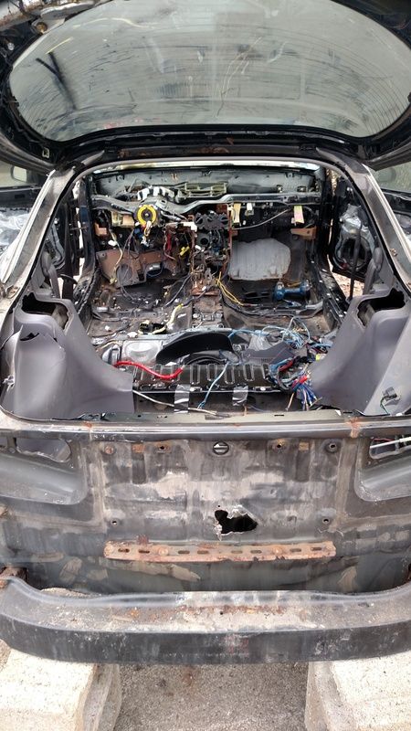

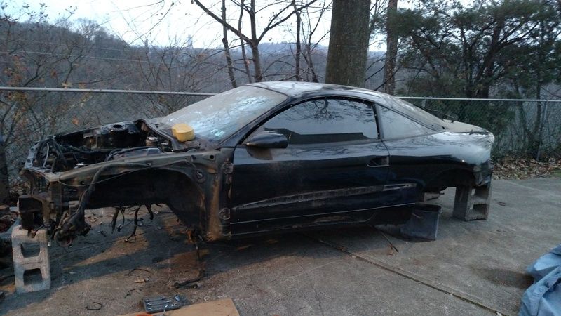

Two more pictures of the old girl, all that is left now is the roof. I'll wait a bit before I harvest that, need a few good spot weld drill bits before I tackle that.
I got a lot done in 2 days.

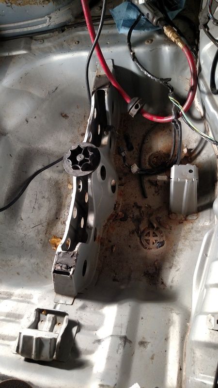

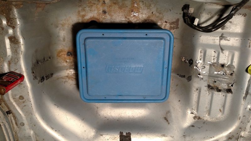

Tons of mockup left, but the autopower roll-bar is fitting well. Also cutting the spare tire holder out and mounting the battery back there.
4

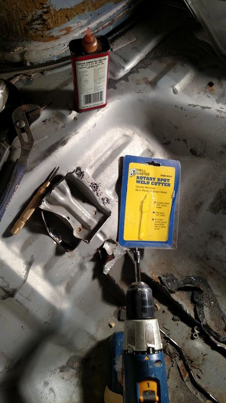

Racecars cars don't need spare tires.
HF spot weld cutter.
This is why I wanted that removed, I want to put the battery back there.

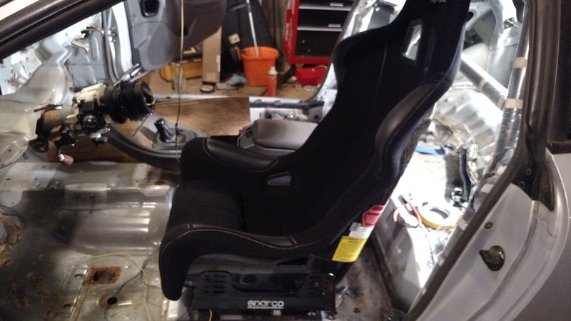

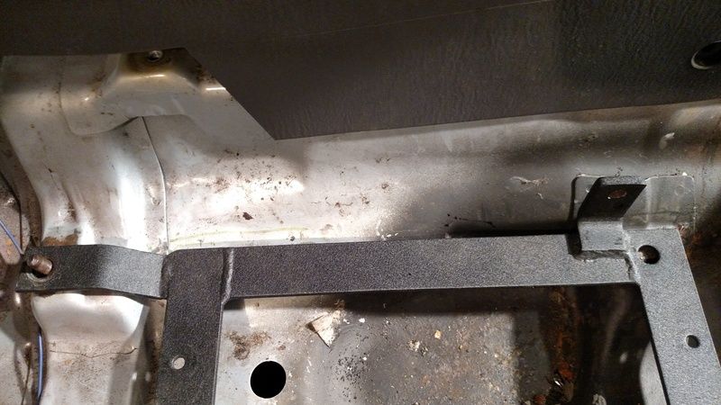

Trying to get the seat position so I can get the holes drilled and weld in reinforcement for the 6 point harnesses.
Still tons of wiring, but I am actually making progress.
Corbeau seat bracket dosent fit. Holes are off and the tunnel needed some tweaking...
I'll make my own for the passenger side as its far from worth $120.
