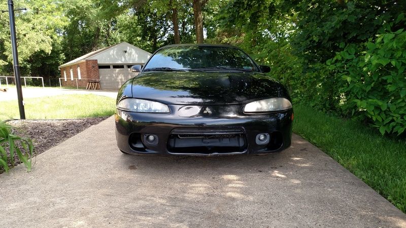

In a moment of weakness I purchased This 98 2G GSX because I knew that my talon was going to take a long time to get back on the road and I wanted something right now that I could play around with for cheap.
The guy parked it about a year ago. The car wouldn't move, but the engine would idle and sounded really good. Over all it was a lot less rusty than the Talon
I took a chance hoping that it just needed a clutch and paid about ~$1300 for it.
The PO, didn't know much about these cars as you can see but it seems like minimal amount of undoing.

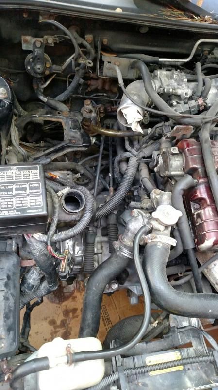

Boost controler... With no logging or tuning, I'm glad the trans went before the motor.

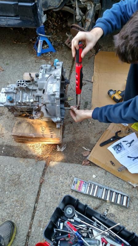

My brother helped me pull the trans with the help of lots of air tools and cordless impacts.

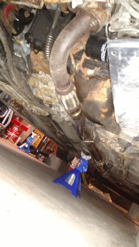

Once up in the air I could see that at some point this car was jumped and must have come down on a curb that smashed up the sub frame. Not sure how I'm going to fix that or just forget about it?
Either way the transmission was going to need to come out of the car. Once out it was clear that it wasn't a clutch failure like I had wished for instead it looks like one of the shift forks may have bent or broken.
Thats how we left it. One of my future goals was that I was going to start messing with the these 5 speeds and see how far I can take a rebuild myself. But for this car I have a stock 97+ awd trans that I was just going to bolt up to this car just to get it onto the road.
Not sure what my goal is, I think just keep it simple and drivable. Now I remember why we just pull everything out, its tough to work around A/C cruse control and all of that nonsense emissions junk. I'll try my best to keep that stuff but....

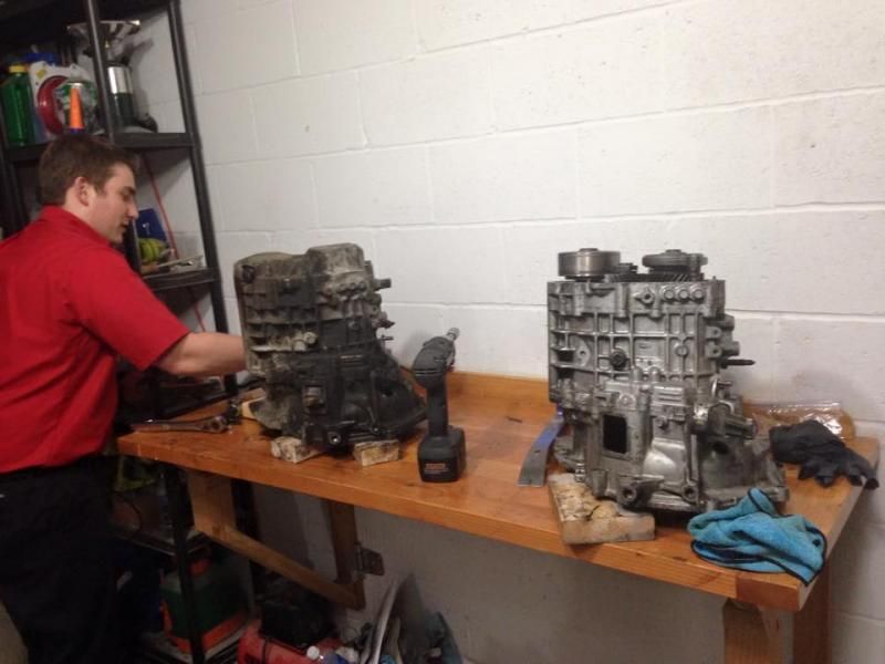

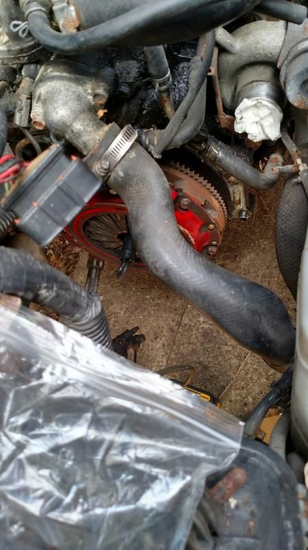

I pulled the trans out of the talon, cleaned it up and installed it in the Eclipse.
New pivot ball with the competition clutch, clutch fork.
Put the act 2600 from the Talon onto the 7 bolt flywheel.

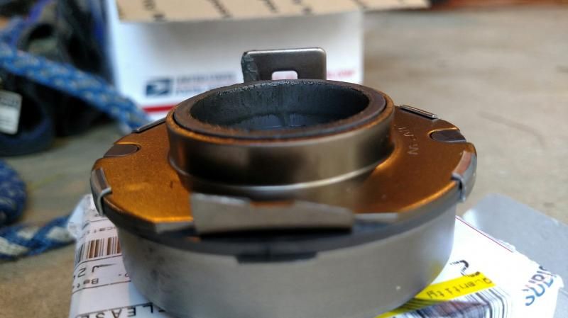

I went to put the new OEM throw out bearing on...But the damn tab was broken off.
Had to use a non-oem TOB, which makes me feel uneasy.
Got it in/on

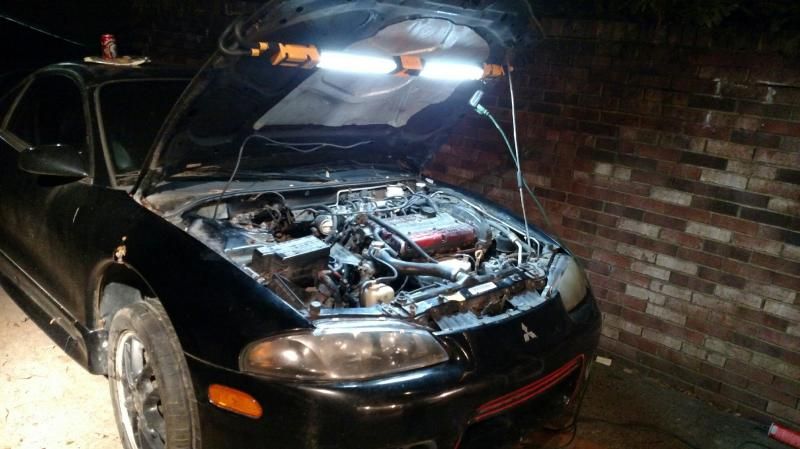

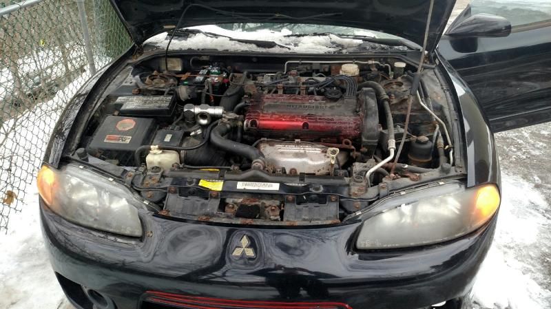

So much nasty crap under the hood.
I love the eastwood light I got my brother, really nice. Doesn't cast any shadows.

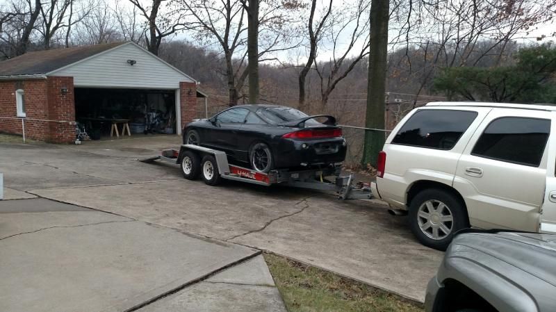

I forgot to order a slave cylinder, not to mention no plate no insurance etc.

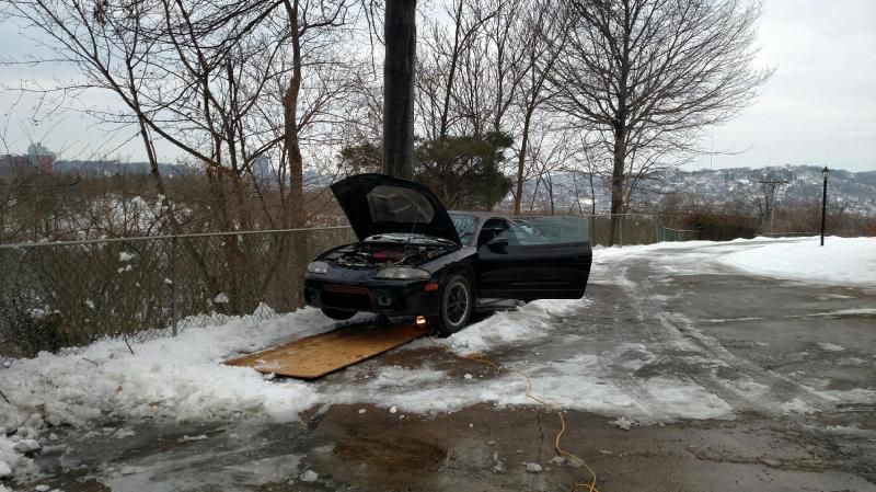

So I got a Uhaul and trailered it home, no more driving 45 min to have to work on it.

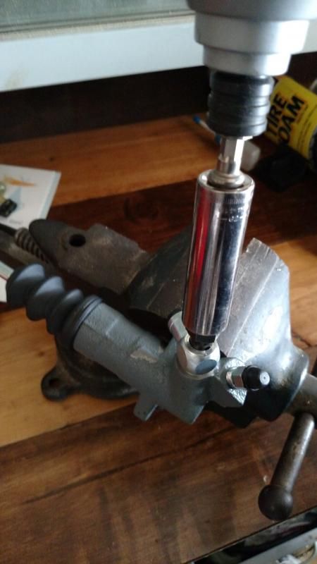

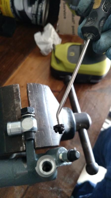

I was able to get the SS braided clutch-line installed and the Oem Slave cylinder.

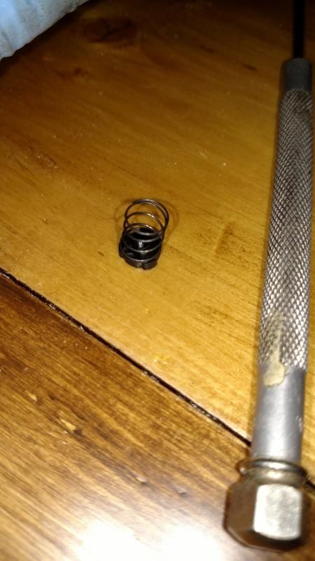

Before installing the slave I removed the restriction valve.
And spring.

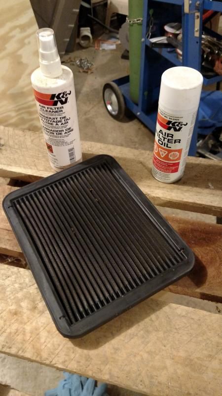

I'm also in the process of cleaning up the K&N that was so filthy and full of debris that I'm sure its state adversely affected performance and fuel economy.

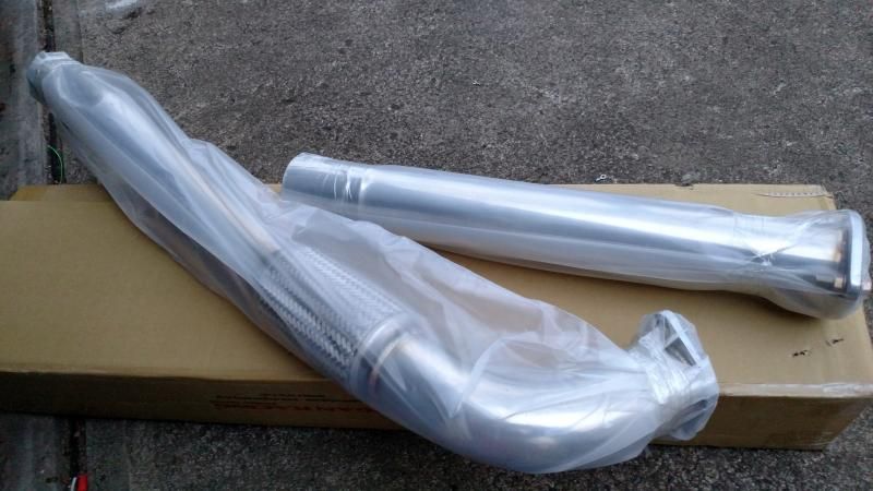

I also picked up a megan racing downpipe. The quality is amazing. I was a bit shocked though that it takes awhile to find the right exhaust parts on eBay for a 2g AWD when the site used to be completely flooded with that stuff for beyond cheap. I think I paid $250 shipped for my full stainless 2g exhaust in 08 and now this alone was like 180. Guess these cars are getting older.

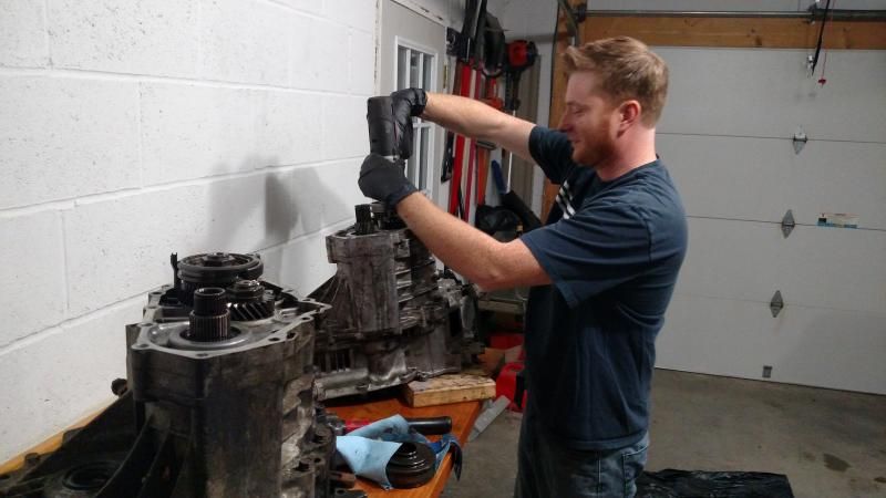

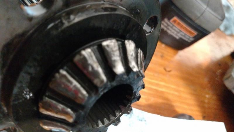

Friday night tear-down party.

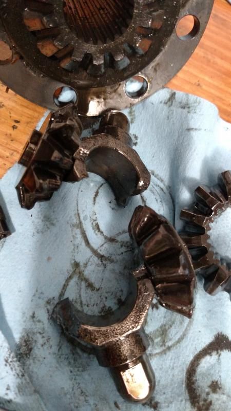

Found what the Previous owner broke on this original trans,
Luckily I have a spare 4 spider, and the rest of the gears looked great so soon I'll get this back together and that way I'll have a spare 5 speed.

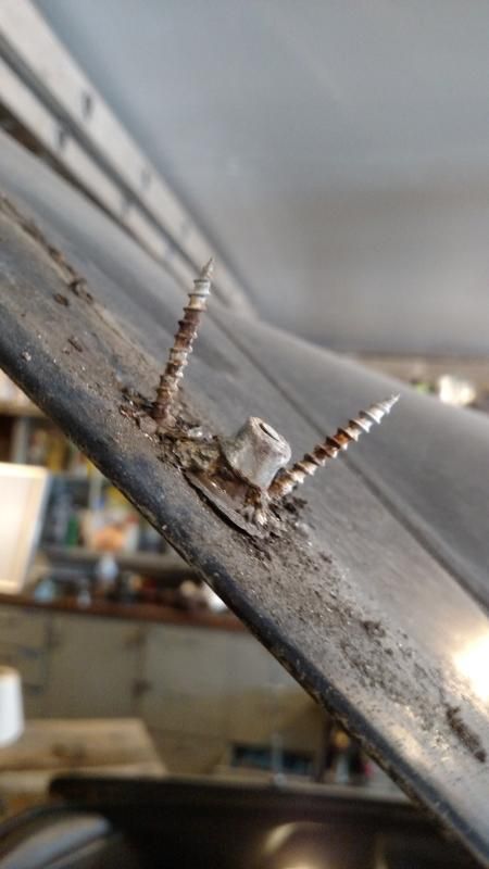

In the garage I was still trying to undo the previous owners work
This is how he had the wing attached,
So until I can get that fixed I'll have electrical tape over the holes.

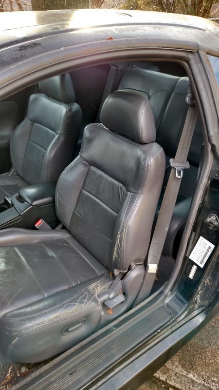

I mentioned the two garbage bags of trash, well this is after vacuuming, armor all and leather treatment. Looking better but still needs the carpets shampooed.

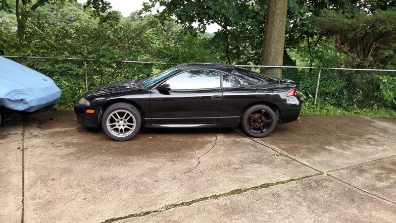

Got nice new sway bars onto it as well as the wheels tires & brakes swaped from my talon onto her. Next is suspension and boost leaks.

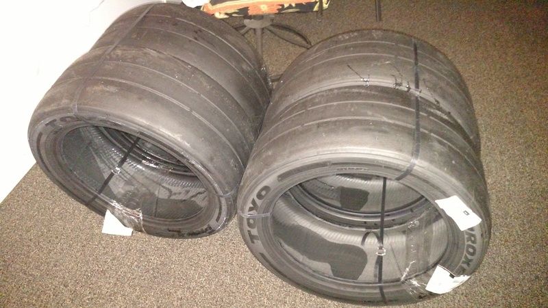

Got some toyo rr's mounted on some evo9 rims!
Can't wait to get them on the car.
