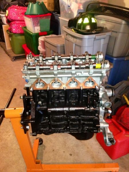

Slapped the old head on... Its funny I see people ask about putting MLS gaskets on their cars with the shittiest surfaces and here I am with two mirrors worried it's not clean enough. I must have wiped everything down 40-50 times before putting it together. OEM MLS gasket with copper spray and ARP L19's torqued to 90 ft/lbs. Went together like butter.
