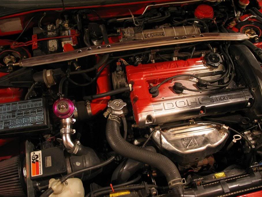

6 bolt in my 2g...not sure what kind of info you want or you can get out of the pics. Still need to make brackets for the coil pack and the afpr. Everything is 1g stuff (block, head, intake mani) except the sensors (duh) and lifters which are from my 2g head. Did the swap this summer in a friend's garage, GREAT way to learn about the car.

I always thought the valve covers were the same for 91-99 cars. 90 cars have a 90 degree breather tube like the GVR4.

I think I was just looking at to many valve covers lately.....his is a 1G valve cover, but I would still like to know just for the hell of it if there swappable?
1G valve cover says 16 Valve DOHC 2000
2G valve cover says Mitsubishi DOHC 16 Valve
Don’t know why but I would rather have the valve cover says Mitsubishi other then 2000? If there a swappable part why not?
Thanks
RevivedDSM
yes, all 4g63 valve covers are swapable. my old one just had a crack in it so i replaced it.

RevivedDSM said:
I guess I just noticed from yours, but the 2G valve cover fits the 1G head?
If so I am going to get my 2G valve cover powder coated and use that so I doint have any down time getting it done.
Thanks
RevivedDSM
All dsm valve covers fit 6 and 7 bolts. That valve cover came with my 6 bolt so i am assuming its a 1g valve cover. The motor was rebuilt with 2g pistons, bored .20 over and has no balance shafts.
Thanks
RevivedDSM
The one that says Mitsubishi .. isnt a 2g valve cover its a JDM one. They usually come from JDM Galant VR4 motors.
Luke :D
4g63 hyndia VCs fit too
