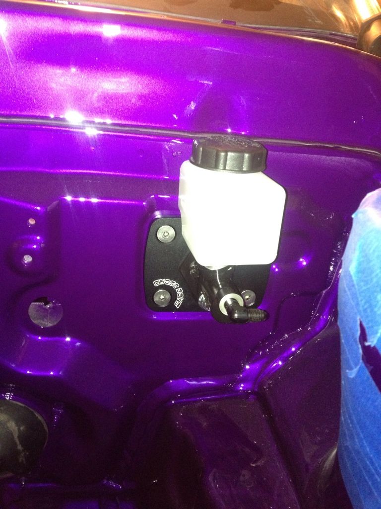

Got my brake booster delete plate and wilwoods master cylinder installed.
I'm still torn on a manual MC on a 'street' car.
Meh I won't drive this car toooo much... I'm more worried about losing one brake line I lose them all...
I hear you on that one! I was going to go with the Chase bays kit but after talking to a guy at Wilwood I decided to go with a tandum. I'm not going to be driving mine all that much either...but I didn't want to chance losing all the brakes. :eek:

Have you figured out yet how to route the line through the fender well? I was looking around the other night and didnt see anything that would be super clean/easy.
swade
Yes, I ran mine just below where the wiring comes into the fender. Then I kept it as close to the inner fender as I could to keep it out of the way. I'll snap a photo tonight and post it up.
That would be great!
I think "Swade's Unicron" would be a more fitting title for this build, after hearing your plans for it. :p
Sorry for the phone pic. This is where I ran mine. It clears everything fine. This seems to be how a lot of others run theirs as well.

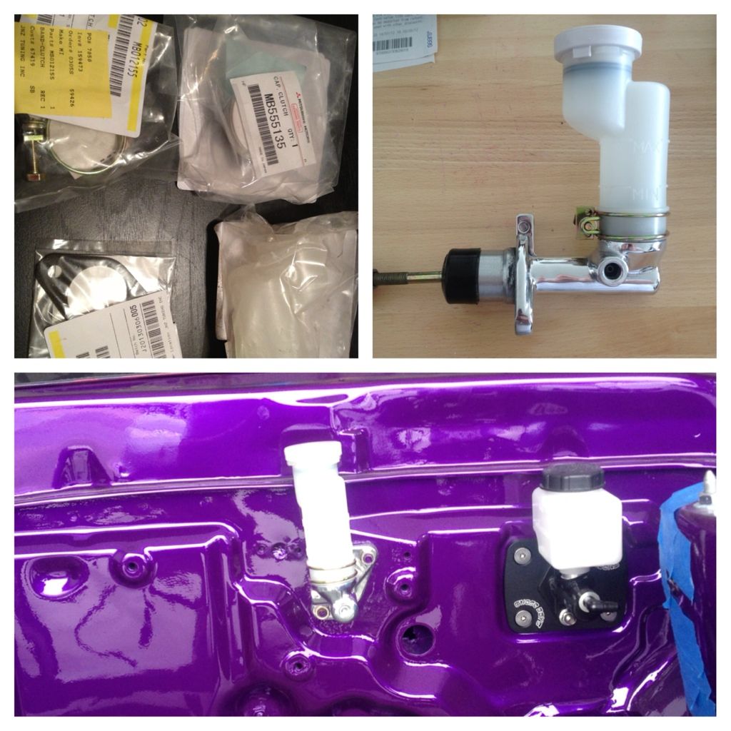

I had my master polished. I went to install it and saw the boot was cracking. Ordered a rebuild kit and rebuilt it. Then went to install and couldn't find the gasket that went between the master and firewall... Made an order with JNZ for that and decided to go ahead and order new reservoir, clamp, and cap also. Finally got it all installed.
