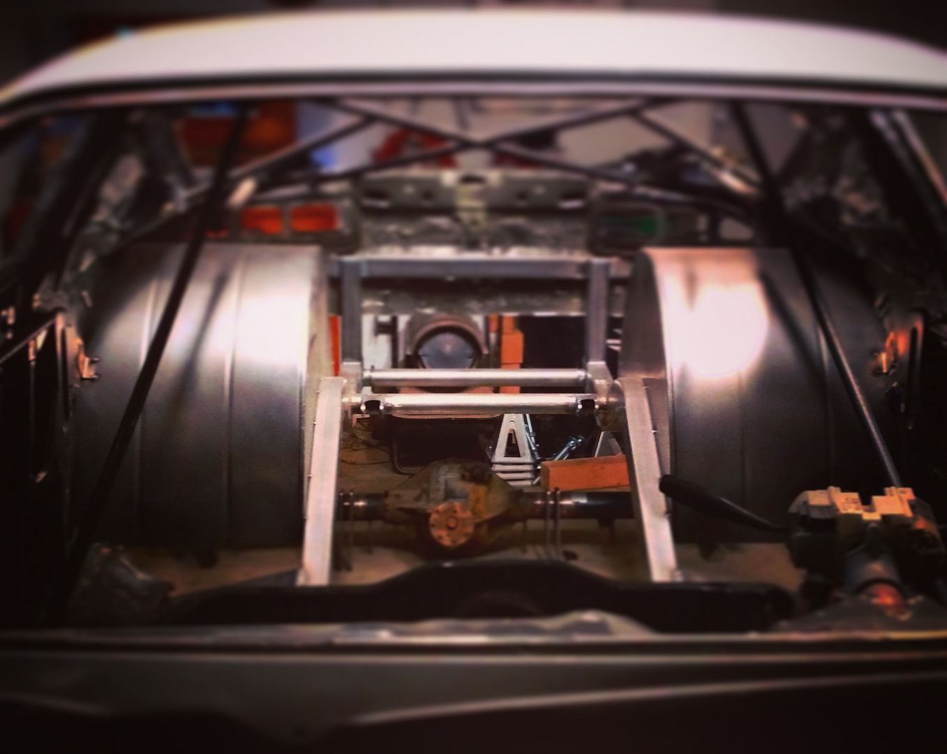

Some pics from last week. Not sure if there's any from yesterday yet but I have some vids to go through. Jumped over to SM because PAX was better.
Uh.... wait, which car is that picture from?
I'm guessing it's from the one he isn't being a pussy with.
