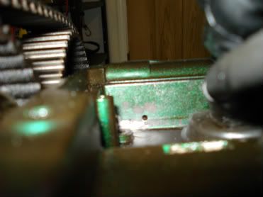

I bought a new cap for the valve cover and put it on, but there was still a small amount of oil leaking out so I doubled up on the gaskets as many people say and that worked. There is a crack in the valve cover, which is causing a leak. Now I see a hole in the valve cover and I believe oil is leaking from there too. I'm not sure if this hole is supposed to be here or not. I put some silver tape on the crack and on the hole and there was barely any oil. I poke a hole in the tape where the hole is and there was more of a leak. Is the hole supposed to be there? I would think not. I'm planning on using some jb weld for atleast a temporary solution. I took a picture of the crack and the hole.

I wasn't sure if oil was coming out of that hole or not, but the leak seemed to be worse when it was exposed. I just put some jb weld on the crack. Just in case there is any confusion, the hole I'm refering to is in the first picture, the second picture is to show the crack.

I'm not refering to the five holes on the top area of the cover, like the one that can be seen in the second picture. I'm refering to that one small hole in the first picture. Were you refering to those 5 holes on the top or the small one in the first picture, I'm asking because you said "holes" and there is only one I am refering to.

That hole goes straight through to the front side of the valve cover. Its like a drain for any oil build up on top of the cover. And for those of you that have noticed the hole but never knew what it is, now you do.

Oil gasket is doubled up and works great, crack is jb welded and currently drying, and b-morr just answered what I really wanted to know. I can't believe I didn't see that the hole goes all the way through:chair: . Problem solved. Thanks.:)
