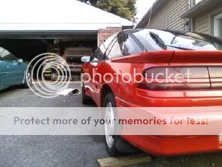

Got her home at night and took some pics that night and in the morning.

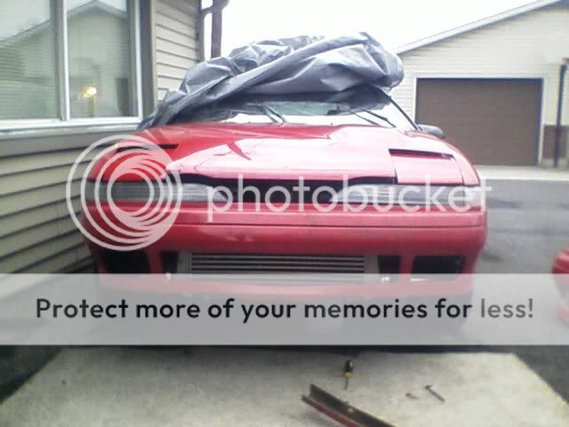

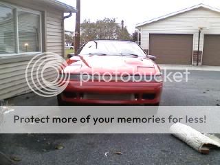

First pic of my new love haha...
I think the pain/body was in pretty good shape compared to the other 1st gens I looked at...

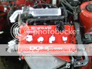

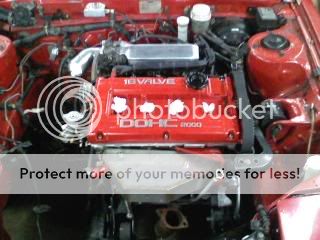

Car was completly stock besides obviously this FMIC and piping that he gave me with the car. We later mounted it higher...

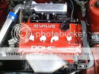

And an engine pic, to the eye it doesn't look like much work is needed...

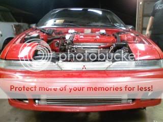

Now a pick of the turbo in the car with the piping n all...

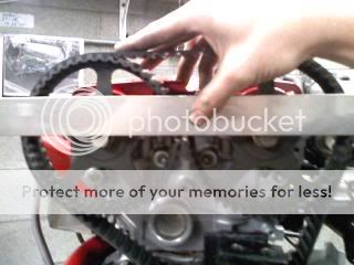

So the head had to come off. Did a leakdown test that revealed bent valves.:chair: Took the head off and one look at the pistons and I knew what happened. I was now looking at this when I popped my hood, and I know the DSM community is very used to pics like this but I'll show it anyways :D
Got all new BC valves lapped in and put my head back on. Got it all back together and she FINALLY ran!!! At this time it had no exhaust and was very loud. It wasnt inspected or registered but I took her out and I fell in love with DSM's. The sound of that 16g and the feel of AWD telling you to sit the F#$% back down was awesome! My only mods at this time were: big 16g, FMIC with the piping, and boost and narrowband air/fuel guages, so I know the car wasnt running to healthy without any tuning device. Never-the-less I continued to take it around the block pissing everyone off with the noise.

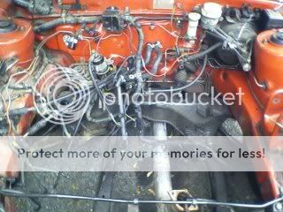

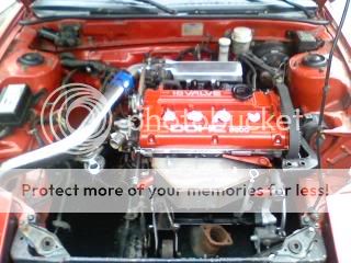

The engine bay...
The body...(I know I wish I didnt cut up the bumper too:eek:)

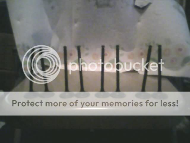

Well I had off today and felt like seeing the carnage in my head from the jumped timing. So I stripped down my head...
Some pics of my head...NAKED:eek:
And finally, GET A LOAD OF THESE VALVES!:chair::rolleyes:
I know I need an actual camera instead of my phone...:eek:
Now my exhaust valves looked okay to the naked eye. I'll have to take a closer look at them at work. How do I check my valve guides to make sure there was no damage? I took a light and shined it down each guide and all looked okay but I know that's probably not the right way.

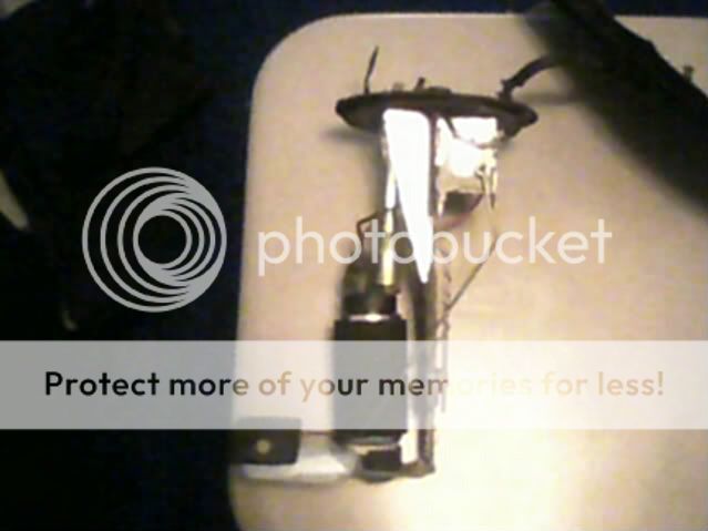

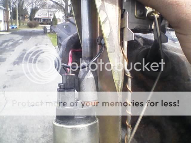

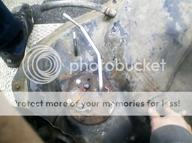

Installed the Walbro 255

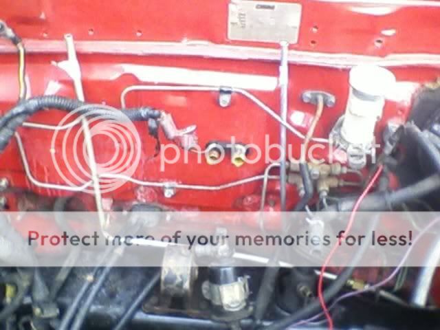

For some reason the pump went back in the tank like a bitch! Broke 2 studs off of the tank. I think it should be ok but I'll keep a close eye on it.

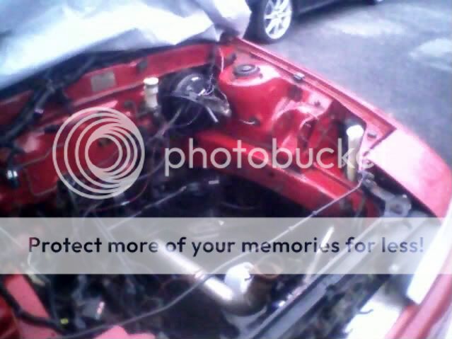

I cleaned up my engine bay pretty good, deleted PS and the AC and removed all emissions crap.

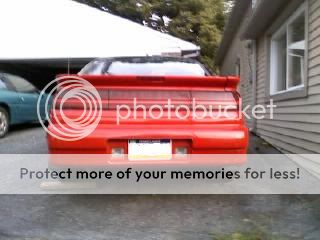

Also went the the junkyard and got my hands on a new bumper cover since I made the mistake of cutting mine up for the intercooler. Look at my first post to see what it looked like all hacked up.
And now, Going to get it re-painted and mount the intercooler a little higher so it's not sticking out the bottom of the bumper. Also just threw the hood on but I think it made the pic look worse.

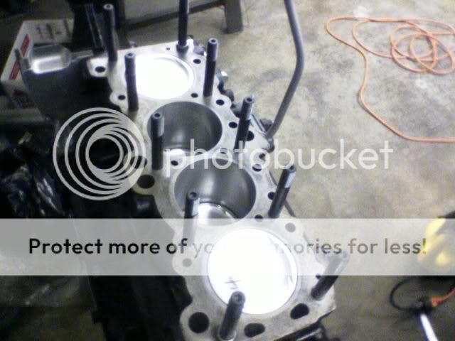

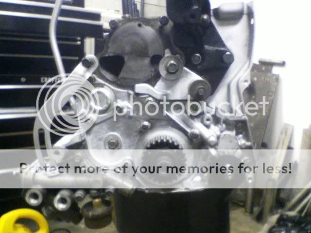

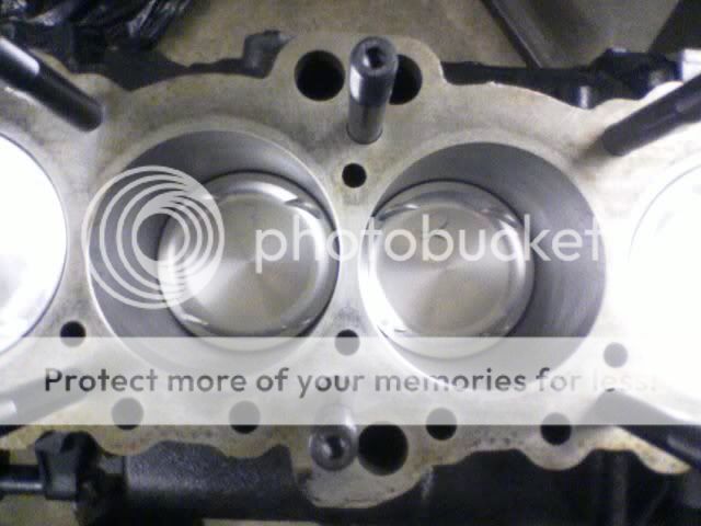

FINALLY I feel like I'm really getting somewhere with this build! I knew from the start it would be a slow and steady build do to my income but the patience is starting to pay off. Anyway I got my block back from JNZ and they did an awesome job. Thanks alot to Eric and Paul for helping me with everything! Here are some pics.
.30 Ross Pistons, Eagle Rods, ACL main and rod bearings, Polished stock crank. Block was obviously line bore and honed .30 over, hot tanked, and the deck was resurfaced.
Balance shaft eliminated, new front case/oil pump
Shot of the pistons

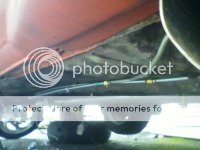

Also something else I've been working on is fuel delivery. Last winter when I wanted to install the 255 I broke the fuel feed line and relpaced that section with rubber fuel line hose. I figured now is the time to take care of that death trap, plus I will need bigger fuel lines soon so it's time to upgrade! At first I was going to go with -6an braided lines, but my buddy talked me into going with 3/8 hardline for the fuel feed and 5/16 for the return. I'm glad he talked me into that becuase it saved me a SHIT load of money and is just as good, although it is harder to do. He showed me how to bend, double flare, and cut the lines and then I had some fun.
This is the oem fitting for the fuel pump. Drilled the fitting out for the 3/8 line and welded it in there.
Running the lines to the engine bay. May not look the best but they hug the outside side of the frame rail and secured to the rail with 3/8 electrical fasteners.
This is where they come into the engine bay. The line on the passenger side is the feed and driver side is the return.

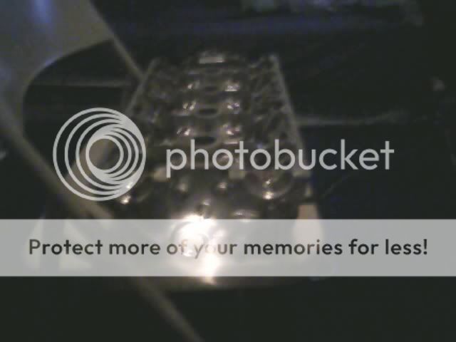

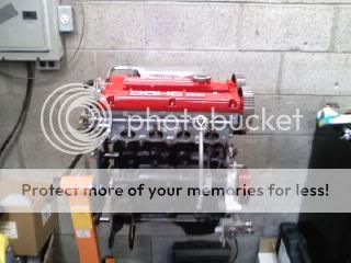

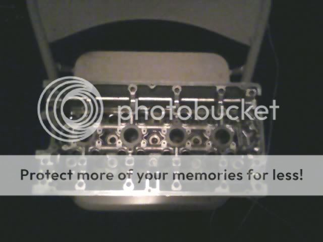

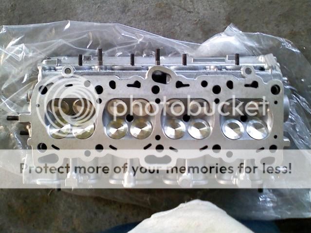

Well it's been awhile but my head is finally done. Ended up taking it to JNZTuning to get built. While my head was getting built I was working on a few things.

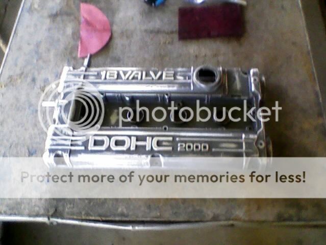

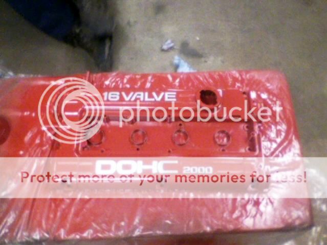

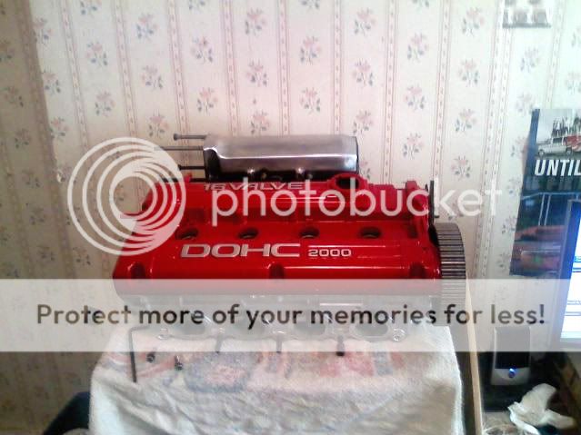

Prepped valve cover for some new paint.
Painted valve cover.

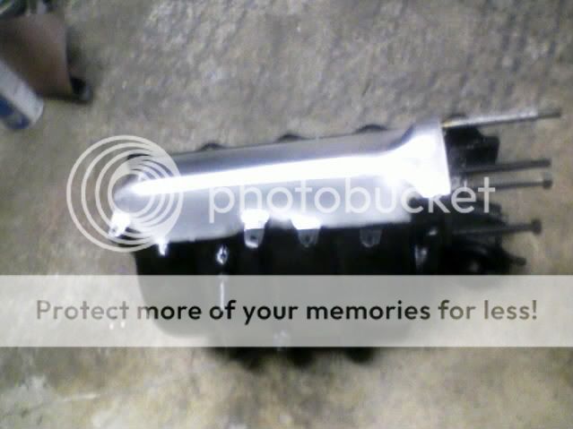

Also did some work to my intake manifold.
Shaved the "Eci multi" and all the ribs off and polished everything up then painted the rest black to set it off better.

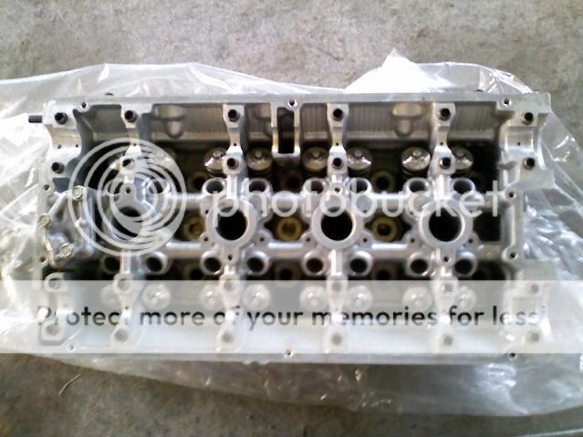

Here are the pics of my head.
Specs:Hot tanked, re-faced the surface, valve seats cut to accept the oversize valves, BC springs and retainers, Si 1mm oversize valves, and SBi bronze valve guides.

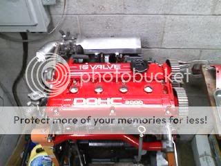

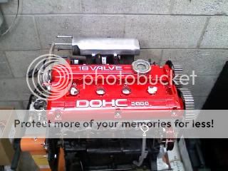

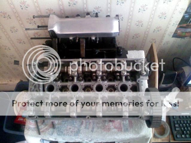

Some pics with the cams bolted down and intake manifold on.
With the valve cover on.

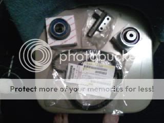

I still need a head gasket, timing belt kit, water pump, and a clutch before the motor goes in the car. With the shootout coming right around the corner that's where some of my money is going so I'm hoping to have the motor in the car by September.:) I'de say I'm about 75-80% done with the build with the two big things; block, head now out of the way. Now it's just buying the connecting pieces to put everything all together. I'm really excited the way it's all turning out.
Before she is on the road I need to get an AFPR, wideband 02 sensor/guage, injectors, and possibly DSMlink. I'm debating on if I'm really going to need a sort of engine management system only running 15psi on the 16g. The only thing that scares me is not being able to see knock as this is a fresh motor with alot of money in it. I'm thinking that it would really be smart to take the link for 300 and be safe as that's a pretty good deal anyway. What do all you guys think? AND LET ME KNOW WHAT YOU THINK OF MY BUILD ALREADY!:p

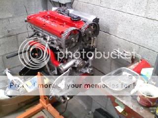

Well I'm getting damn excited as it's almost time for me to drop my motor in the car. I'm shooting for this weekend, probably Sunday that it goes in. Got the water pump on, throttle body, and tb elbow. I also painted my oil cap and CAS cover black. I still have a few things I need to do before I can drop the motor in. I need to make a stop at Extreme Psi after I get paid tomorrow for a timing belt kit and I need to throw on my exhaust manifold with the engine hoist bracket.
It's crazy for me to think it's almost been a year since I started this build. I honestly thought I would be done for the start on the summer. As almost everyone here knows not everything goes as planned on these big money builds and things have to be pushed back. I just looked at some of my receipts and god d@mn I spent a lot of money!!! The longer than expected wait also makes everything that much more exciting for me. Sorry for my rant, here are a few pics of the motor and some of the actual car since I don't have many good ones up.

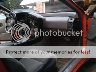

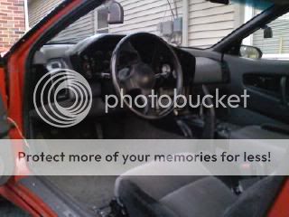

Wish I would have took some before and after pics of the interior. Took all the seats and everything out and cleaned the carpets and armor all on the dash and panels and such. Rear seats are out as of now, dunno if I'll keep it that way or not.

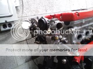

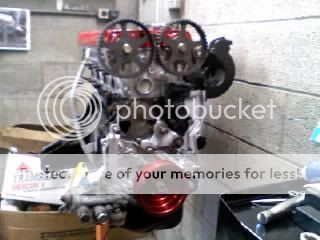

And another motor pic with the water pump, pipe, TB, TB elbow, painted oil cap, and painted CAS cover installed. Today I'll be putting on the exhaust manifold, bracket for hoist, and possibly my custom heat shield if it will fit with the hoist bracket on there.
That's it for now. Will be updating this weekend if everything goes as planned and my motor is in. *Fingers crossed*

Alright couple of big things happened the past week. First off Thursday I had to call all around to try and get a timing kit before the weekend and thank god for Extreme PSI! I had my kit the next day and installed it Saturday...
This is what I didn't by last summer that I should have and I probably wouldn't even be doing this build, but I didn't and here I am. :p
Nice and tight and on all the marks!
Then I threw the timing belt cover on there, knock sensor, crank pulley, and then finally time to put the motor in! I forgot to take pics of the actual process but here she is finally in there!
Damn she looks good finally in there, but not good enough! Surprisingly everything went pretty smooth putting the motor in besides the fact that I put the rear mount on upside down.:eek: That was all for Saturday though as it was getting late so we called it quits.

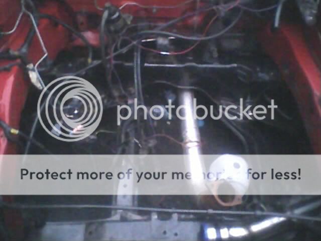

Earlier today I was viewing the clean/shaved engine bay thread and got pretty inspired so I decided to get to work. Here is my attempt at a decent wire tuck.
First a before pic...
After...
Before...
After...
That was about an hour or 2 of messing around with the harness. The only real electrical work I had to do was extend the fuel injector plugs a few inches. I plan on doing a little more once I get the transmission in. That shall be it for now....:cool:
