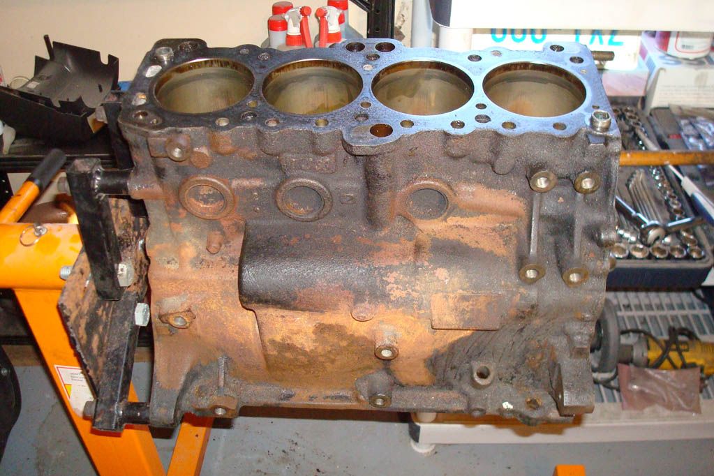

The 6 bolt block I grabbed for a steal.
Block will consist of all ARP hardware, Kiggly gridle, 1G big rods (which I already have), 2G pistons. Still looking for a head I'm torn on weither I will run a 2G head or not. Regardless it will be freshened up with new parts and seals and some Kelford cams.

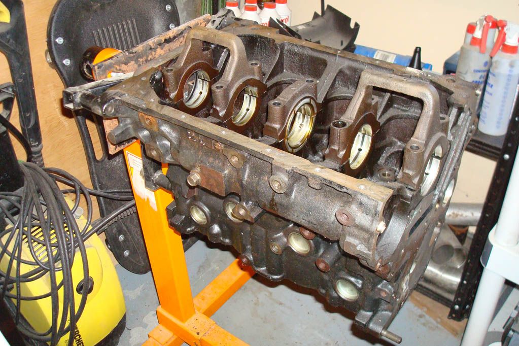

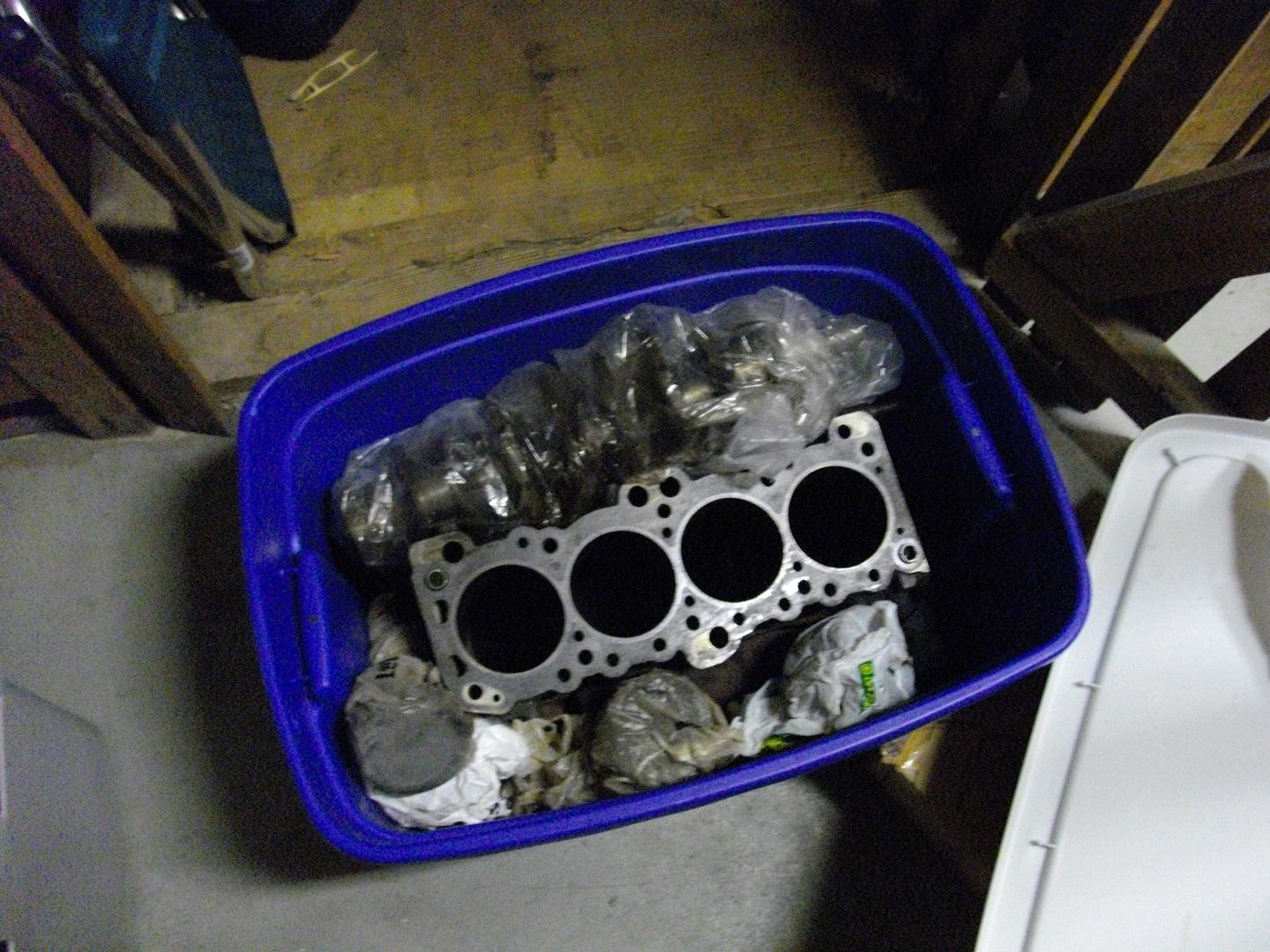

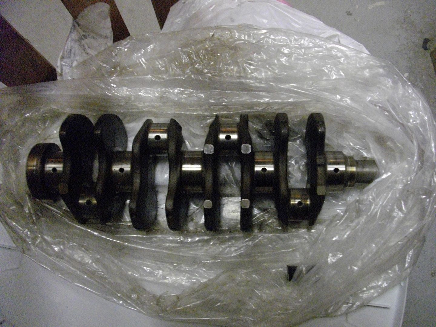

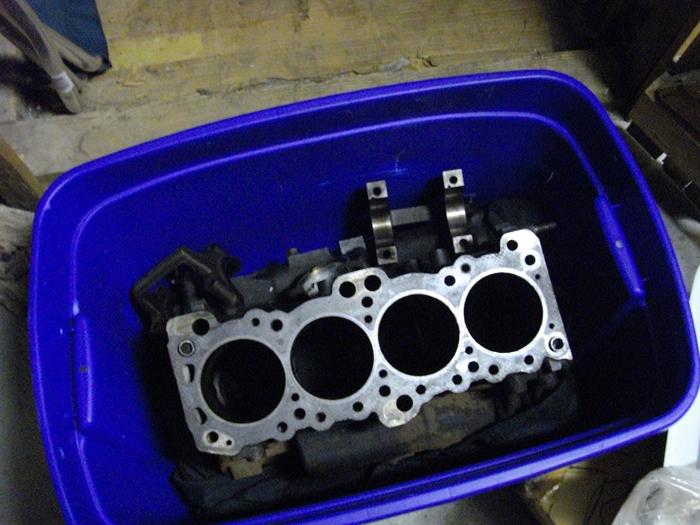

Oh hai! 6 bolt block and crank, looks pretty good but I need to get unlazy and drop it off for inspection.

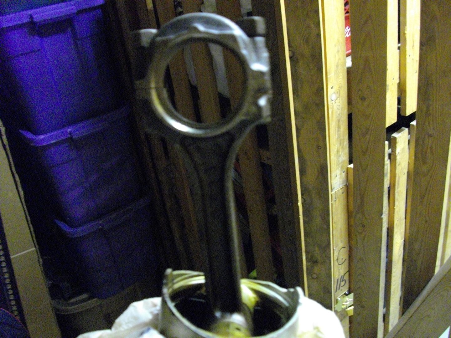

1G Big rods, the pistons are junk because they hit the valves.
Providing everything checks out at the machine shop next week, I'll be buying some Wiseco 9:1 CR .20 overbore pistons for it. I won't mention that I pretty much need to buy EVERYTHING for this block as it's completely bare.

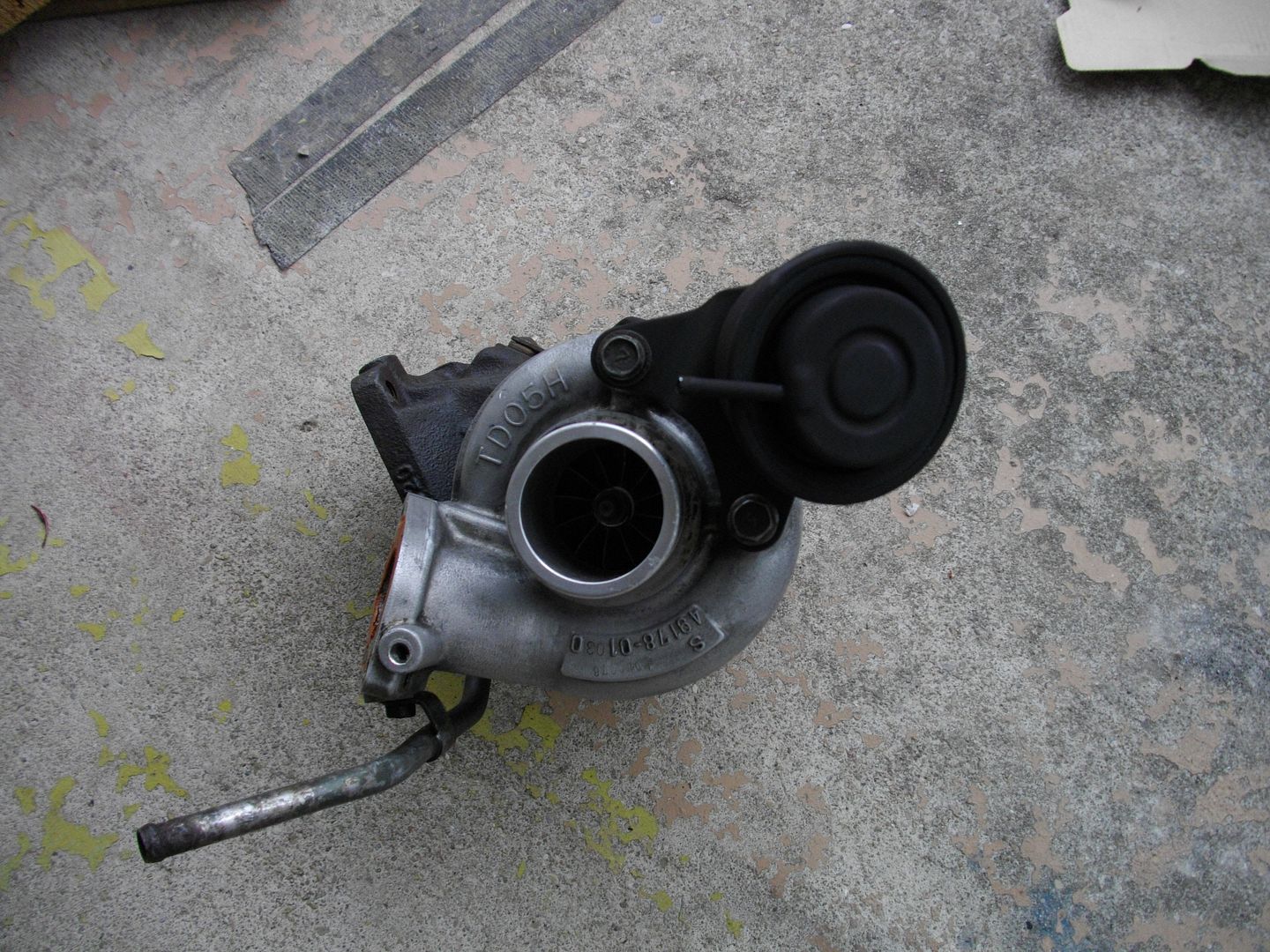

14B Turbo, got it for cheap and it will allow a bit more fun once I have all the supporting mods for it (FMIC, Injectors, AFPR and pump).

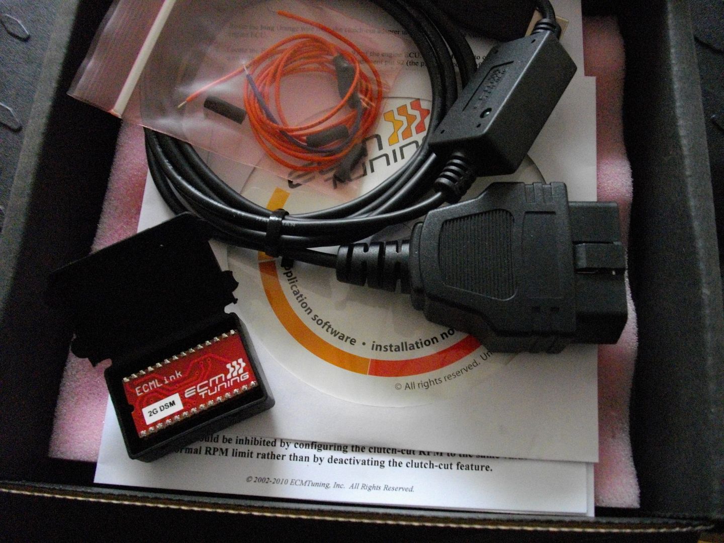

ECMLink Lite V3, got it on sale from SBR and couldn't resist. I can now retire my sub par EvoScan logging software and be able to tune at the same time.

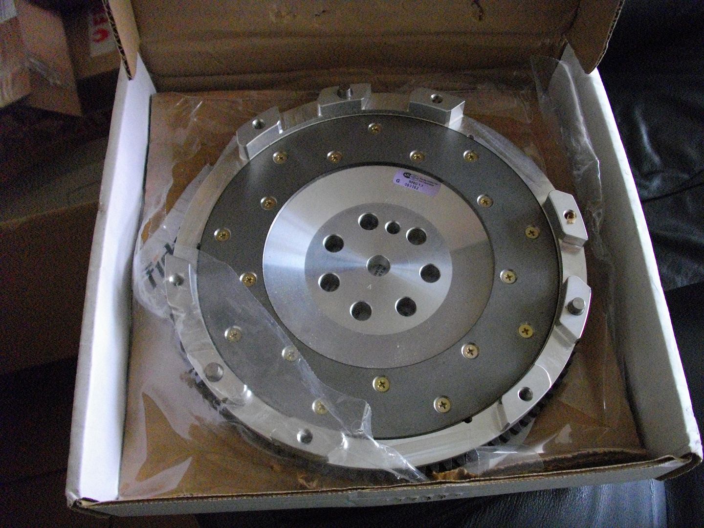

Fidanza Aluminum Flywheel. Stock is 19lbs, this one is 9lbs. IMO this will wake up the car big time.

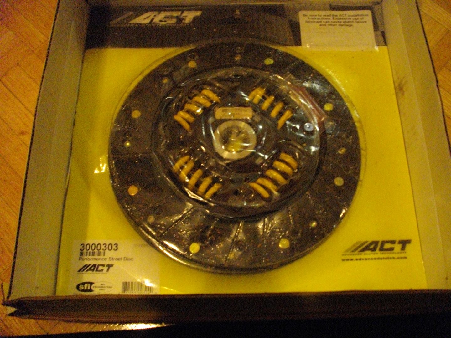

When unpacking I noticed that I forgot the ACT Street Disc, d'oh! So I had to place an order for that, Ziggy @ RTM Racing is loving me right now lol.

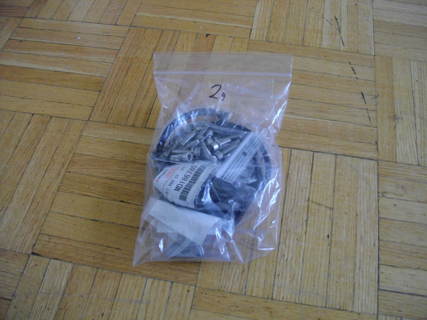

Balance shaft eliminator kit with new front case seal, oil filter housing seal, front crank seal and rear main seal.

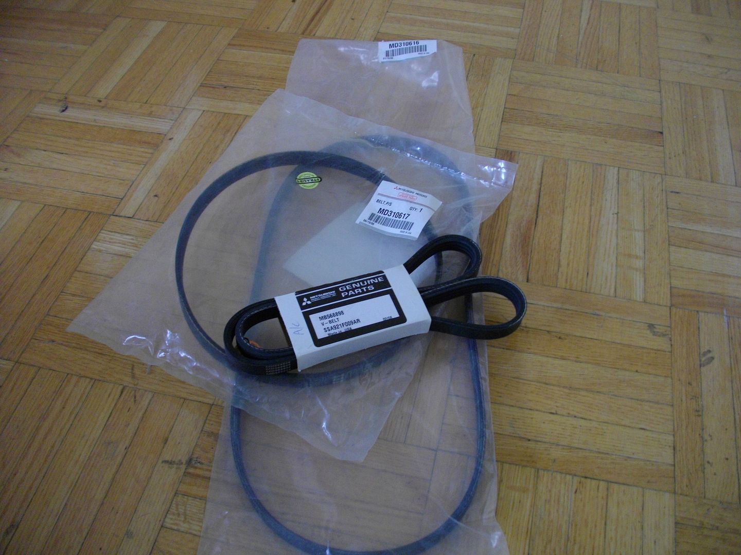

New Accessory belts (A/C, P/S and alternator).

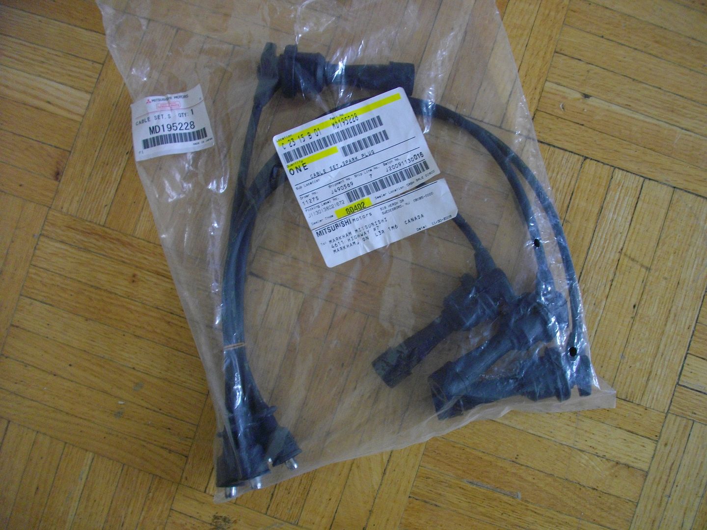

I think this one is self explanatory, spark plug wires.

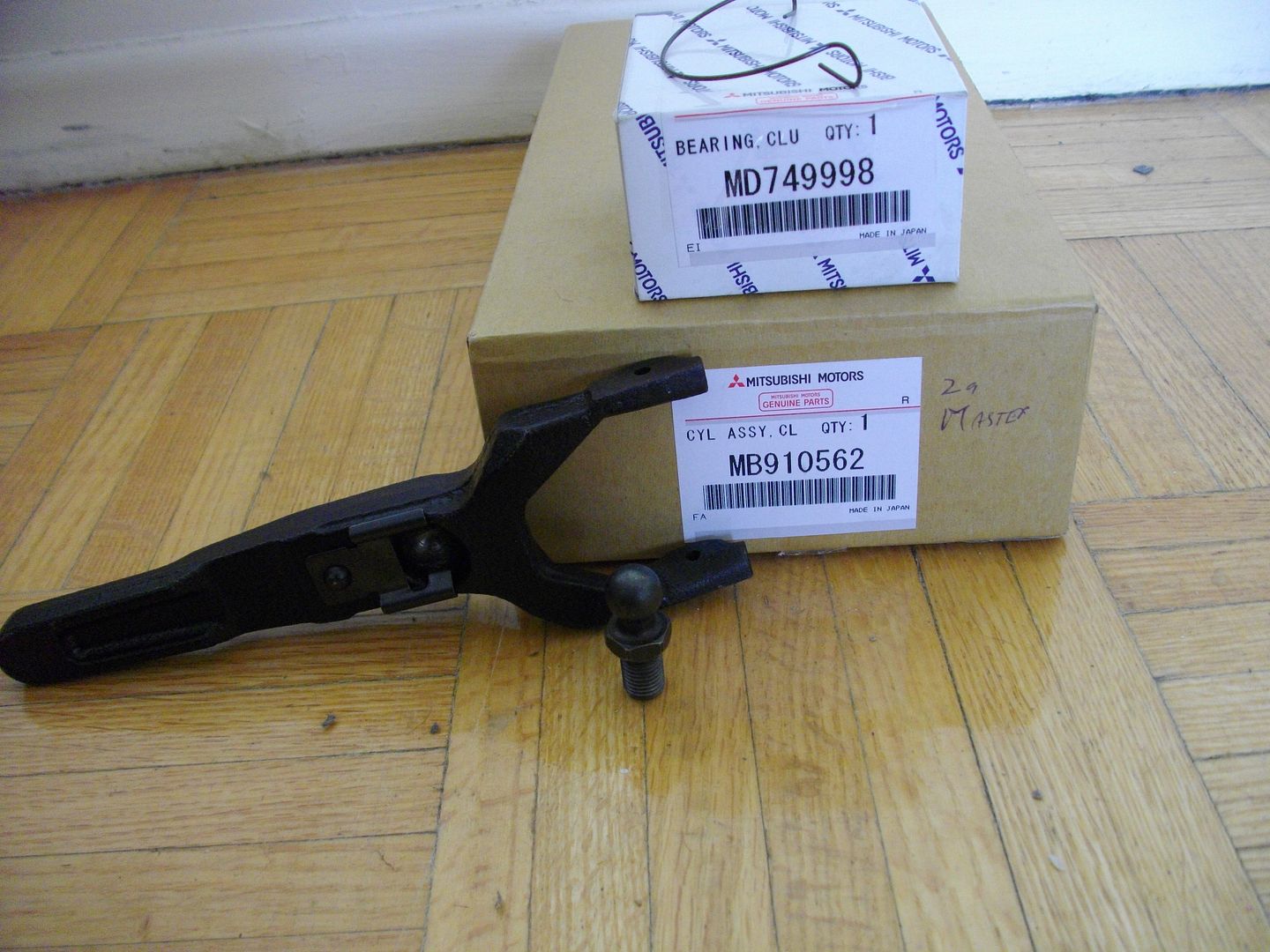

More clutch parts too, slave cylinder had to be ordered in so it will be here tomorrow (along with more goodies). However here's my new master cylinder, clutch fork, pivot ball, TOB and TOB clip.

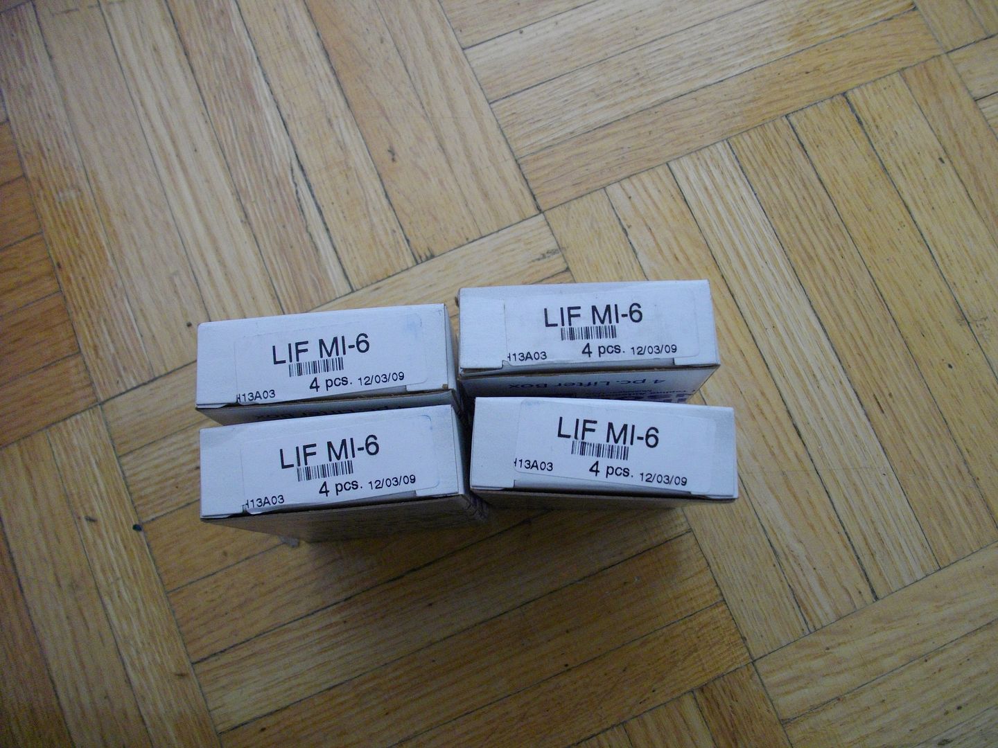

Got tired of my ticky lifters so here's 16 new top line lifters.

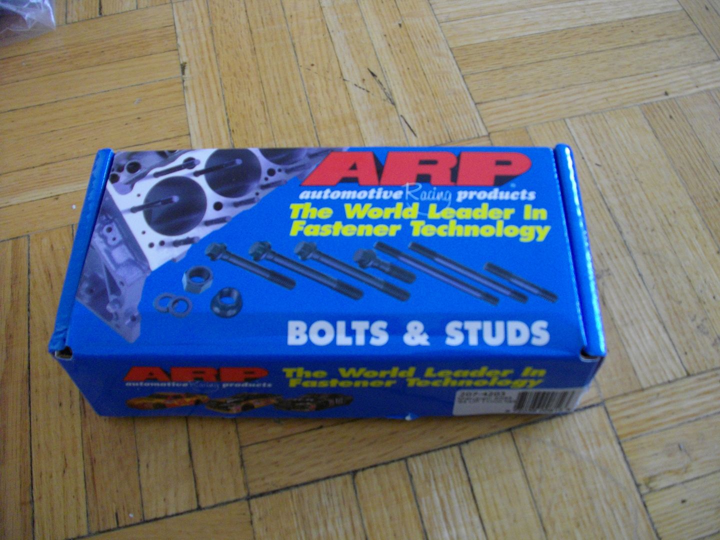

ARP Headstuds for boosting over 20PSI.

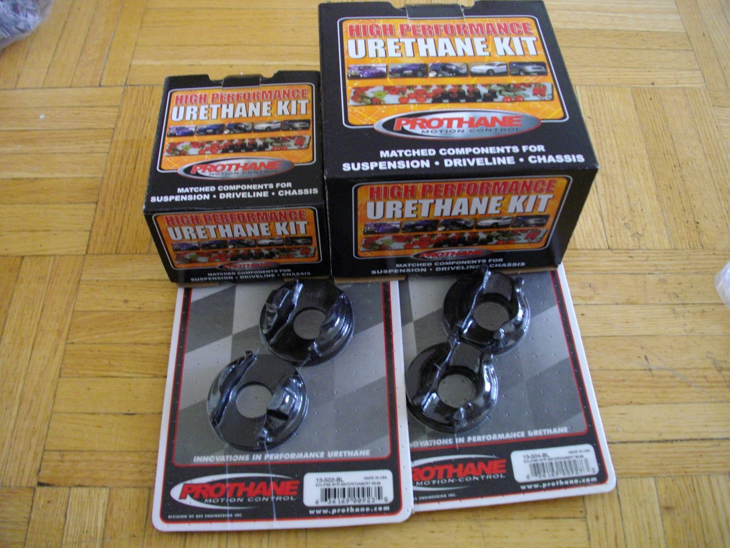

Prothane poly motor mounts, front and rear inserts, sides are complete replacements. Car will be rock solid and with out the balance shafts it will likely shake like a crack whore.

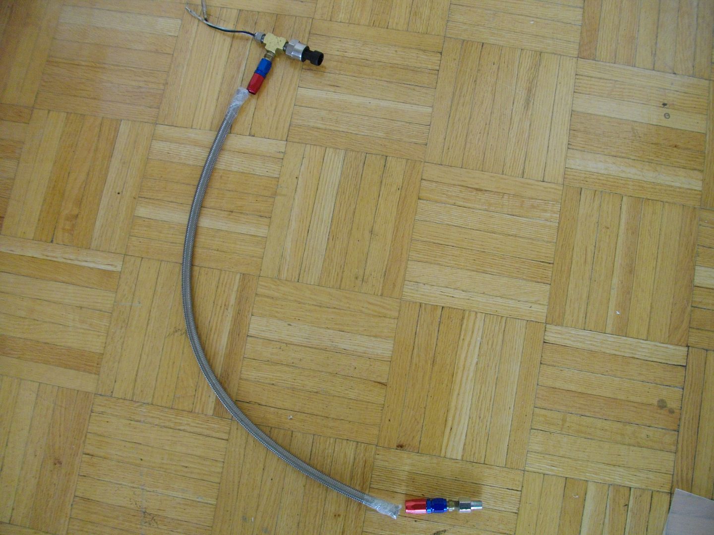

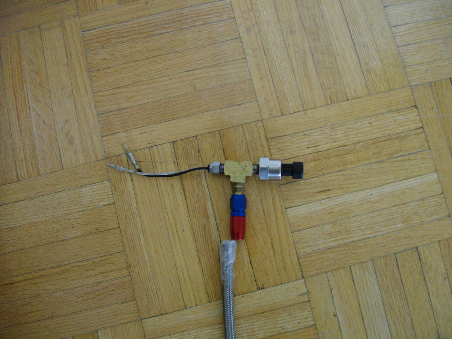

-3AN oil line to remote mount my oil temp and pressure sensors, I need to get some 1/8" NPT to 1/8" NPT Male to female adapters so I can get some space between the two sensors.

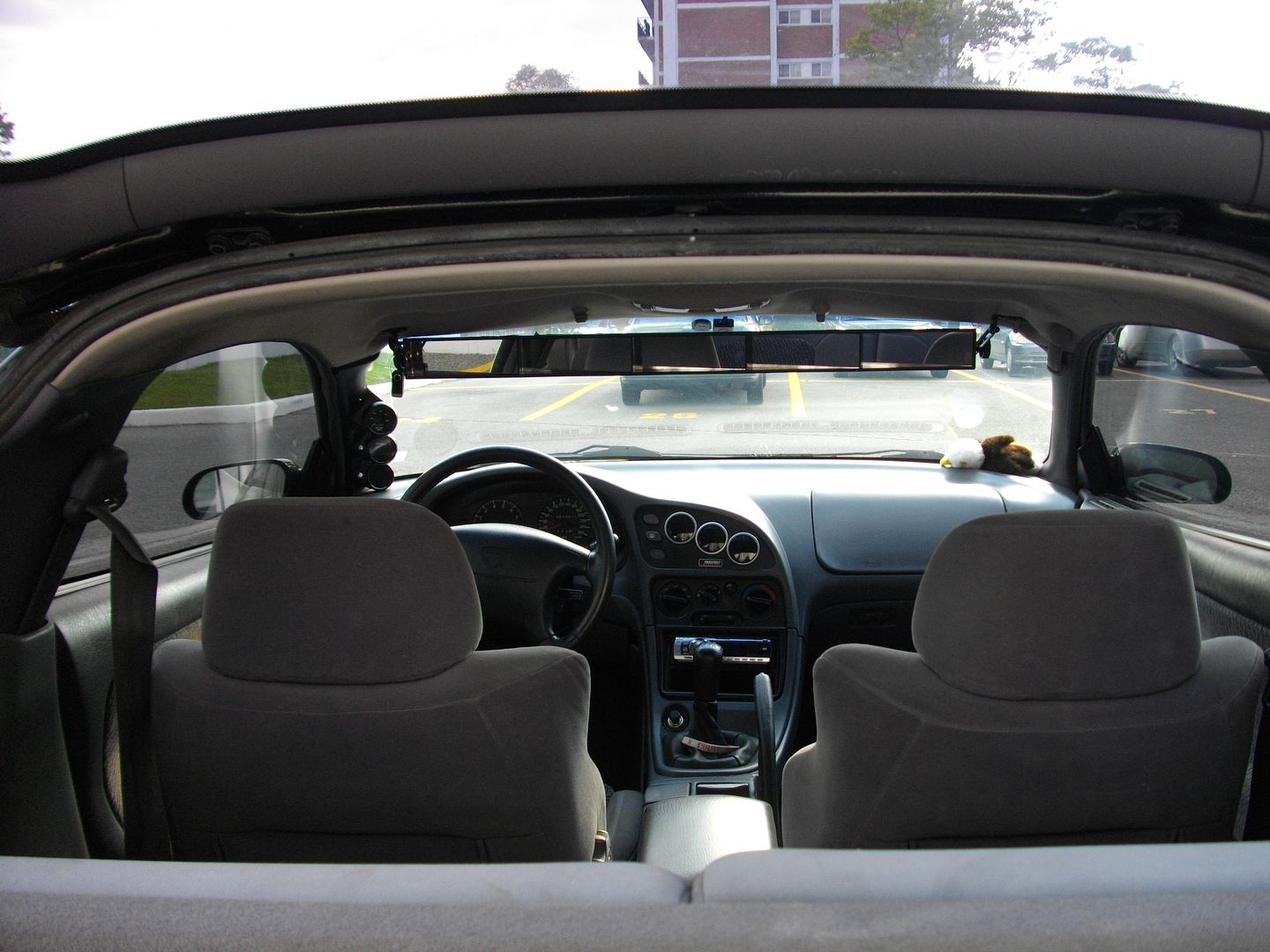

Here's the other thing I've been working on slowly, I just removed some stickers and redid it. It's a 5 panel wink mirror.

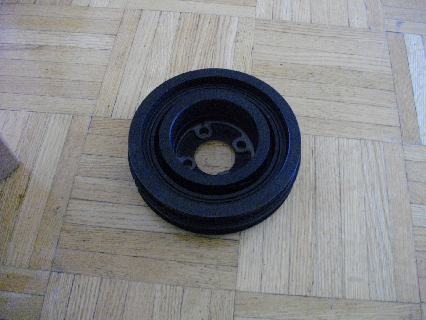

Grabbed an OE-Style harmonic balancer/crank pulley. Since the rubber wears out on these and they are considered a wear item, I decided it's better safe then sorry.

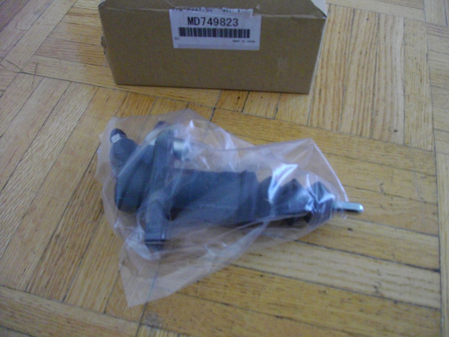

My new slave cylinder, OEM Mitsubushi.

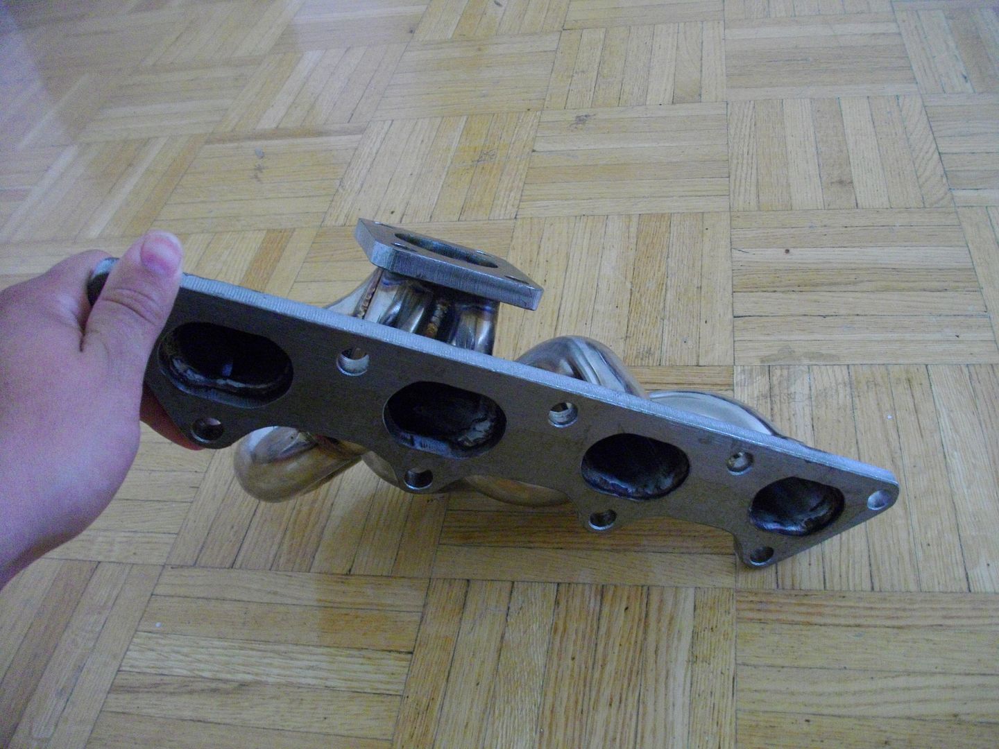

Since I found a crack in my manifold, I decided to buy a nice tubular one to add some bling in the bay. Ok it's Chinese but the welds look pretty damn good so I'll take my chances.

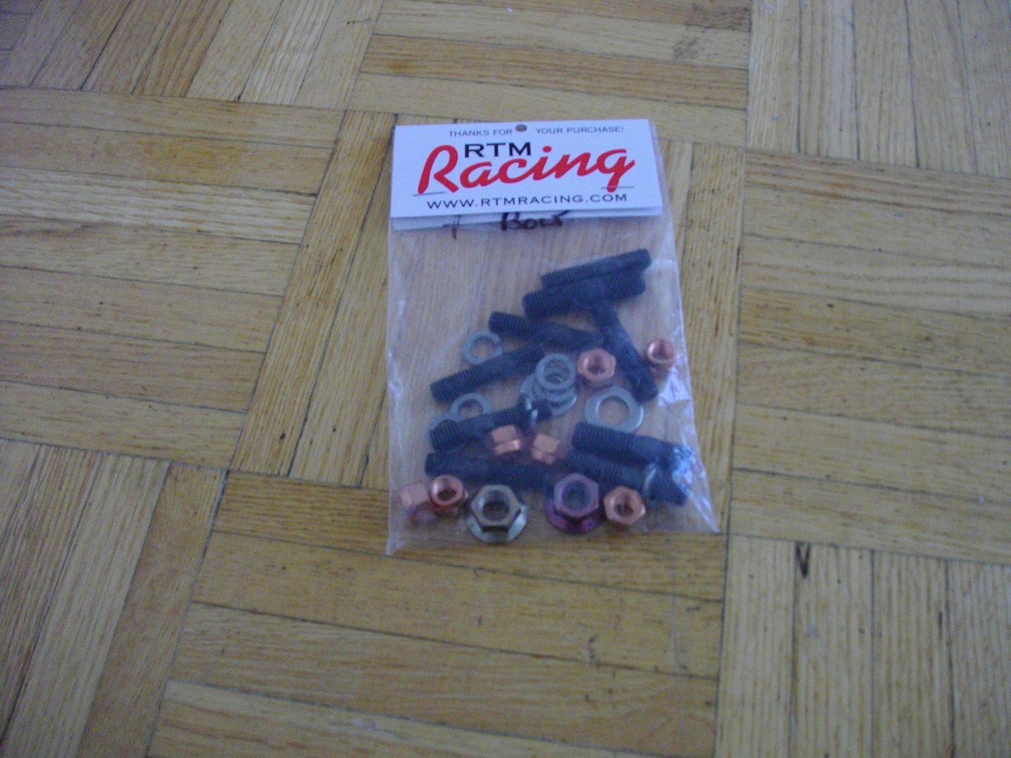

New Exhaust manifold studs.

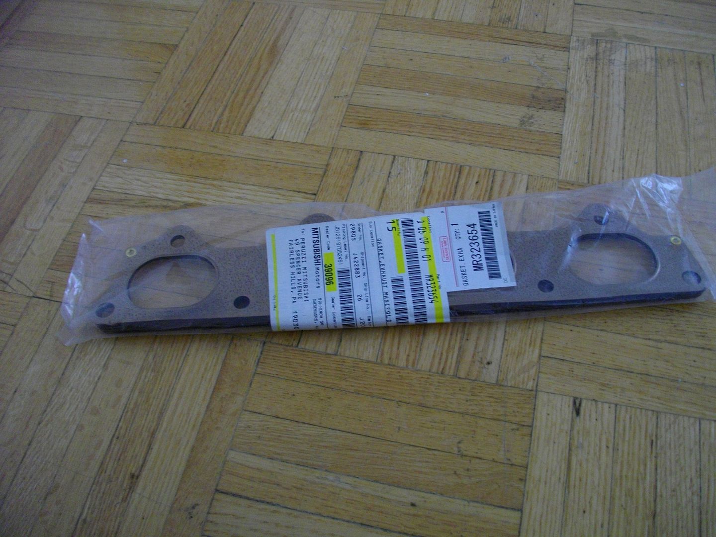

Lastly, an OEM 4 layer exhaust gasket.

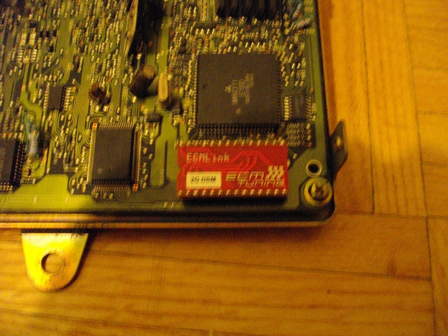

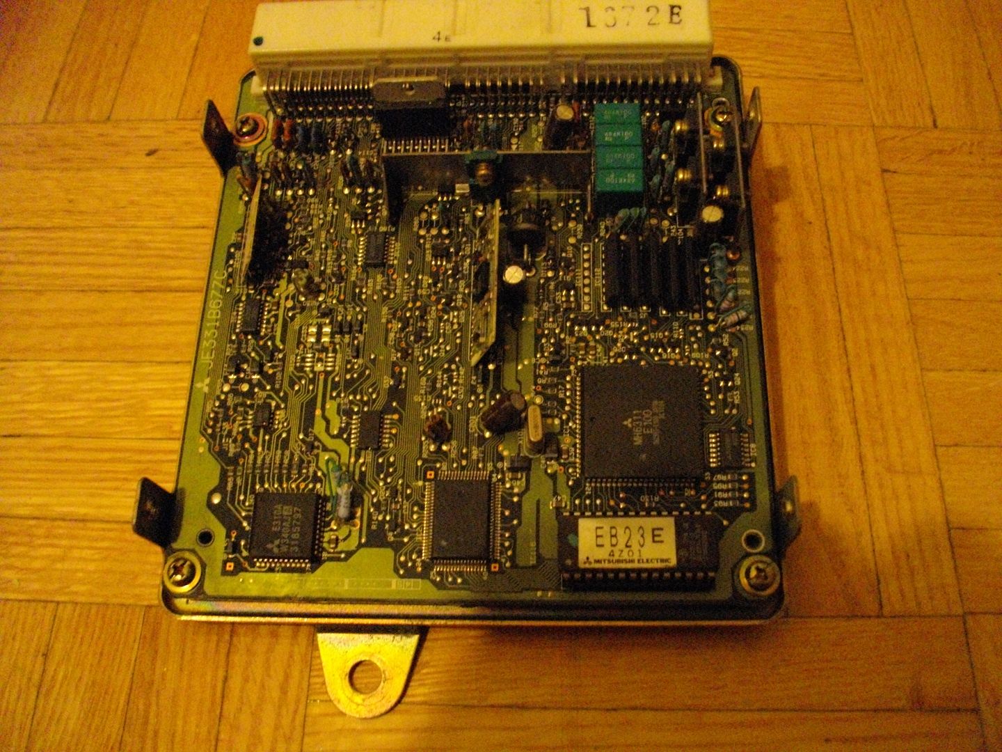

My EPROM ECU is now here. It was socketed and had the caps replaced by Thomas at ECM Link about a year ago.
With the ECM Link chip in place. I can't wait to start playing around with this.
My street disc showed up.

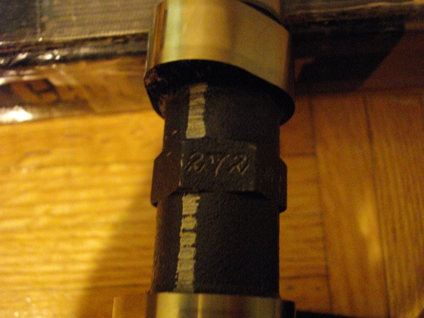

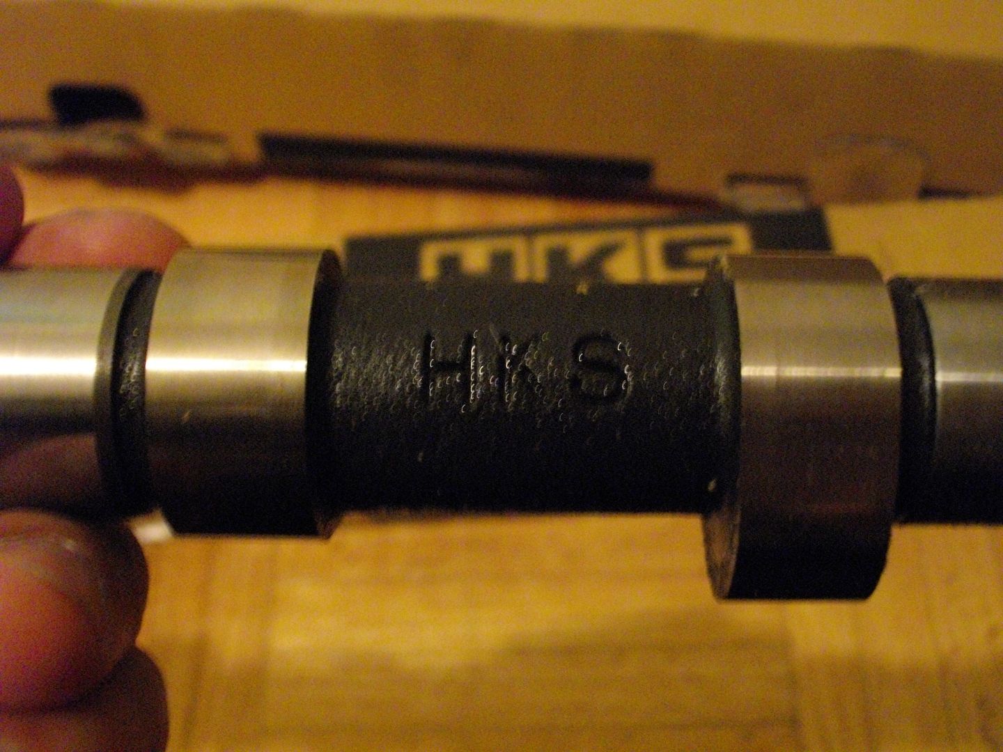

HKS 272 cams, cannot wait to hear the car loping away at idle with these bad boys.
Counting the days till she goes under the knife!!

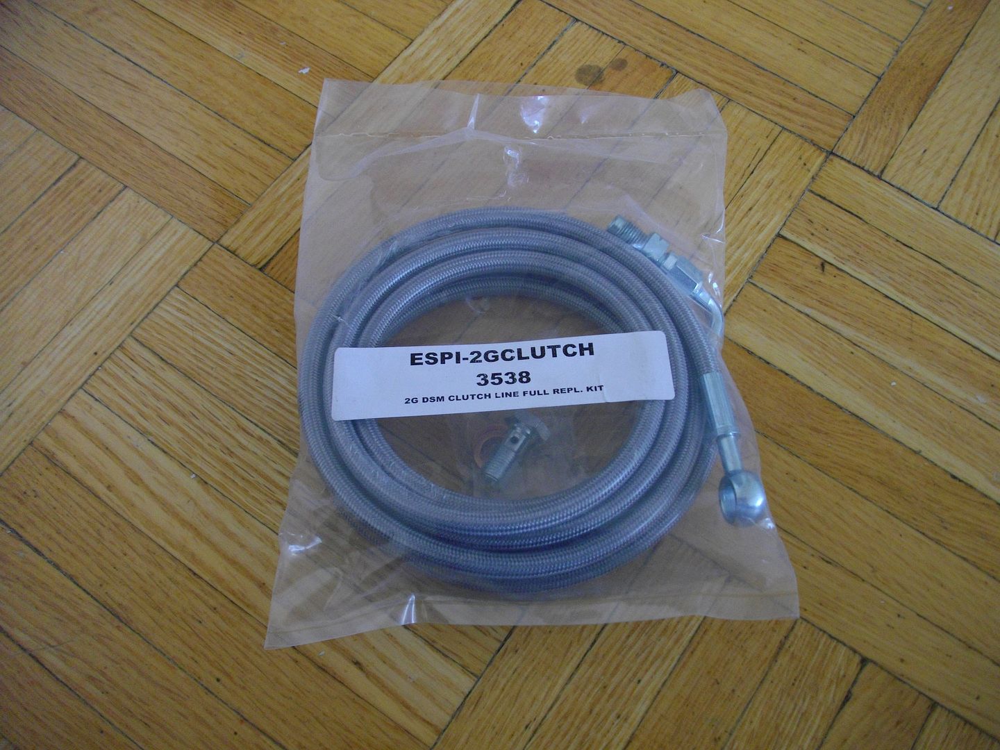

The last pieces of the puzzle showed up today. Starting with a 2G complete SS clutch line from master to slave (removed the accumulator).

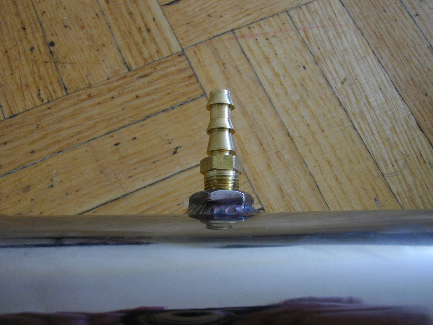

Hit up a Part store for some fittings, first is a barb fitting for the lower intercooler pipe boost source.

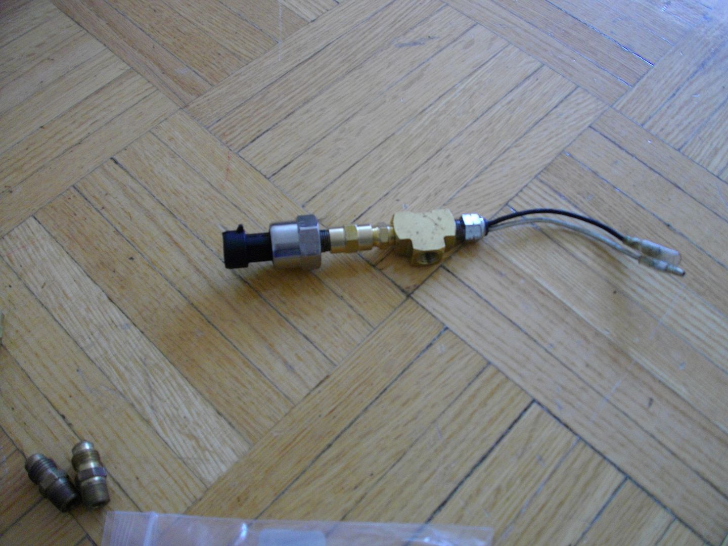

Also got fittings to space the oil sensors apart, it's ugly but I'll support it with some padded wire clamps.

Here's some pictures of the wink mirror, I get a lot of questions about it. Some hate it, some love it.
