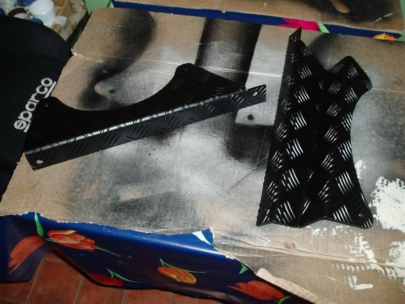

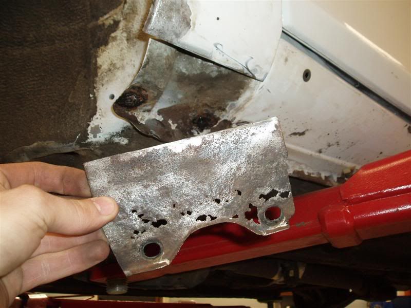

- More weight saving with carbon hood, new trunk with makrolon window, remove crash bars and replace them with aluminum brackets.

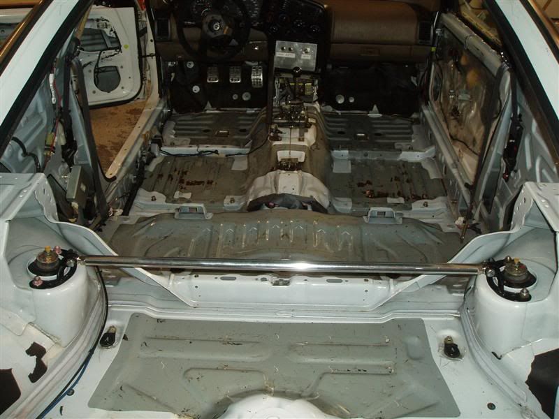

Just bolted them in the door. It weights 2770lbs with 2/3 of gas. The aim is to get it down to somewhere around 2650..

Next I will buy a cf hatch and put lexan on it and a cf hood. Been thinking of removing the pop ups if I can find a cf hood that covers them. I'm also gonna replace the crash bars with aluminum brackets and replace the tank with a fuel cell. And I have plans to modify the roll cage with bars to the front strut towers for more rigidity but thats another story.. no shortage of ideas anyway, just have to make them happen:)
