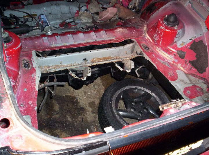

Its going to be a syncro trans built by dogboxracing.com not a dog box gear trans. My goals with the car right now are 500awhp, 2600lbs. The car is going to be a well put together drag car that will be drivin in the street, 2 seats, stock dash, carpet, etc. But still going to be very light with gutted doors with aluminum sheet door panels, aluminum sheet rear floor with 5 gallon alumin fuel cell, gutted hatch with lexan, pin on fiber glass hood, lots of light parts, but still manitain streetability and class as it wont look likea tin can drag car.

Today i got the wheel wells all painted black, and got some lower springs, i had pro kit springs on there, now i have sportline springs. Its pretty funny, the car is so light even with sportlines(2inch drop) there is a good 4 inches from the tire to the fender/quarters. Eventually ill get ground control coil overs on agx's. But these will do for now. They are sportlines on kyb gr-2s. Big thanks to my friend Craig for the suspension!

Heres some pics of mock up for the intercooler pipes/fmic. Full 3 inch upper and lower piping... Still need the Q45 TB, but i did oreder a 3.5 to 3 silicone coupler and a tial bov flange to weld up...
And some pics of how high it sits with 2 inch lowering springs.. DOHHHH looks like i need coilovers. Lol my car is too light!
