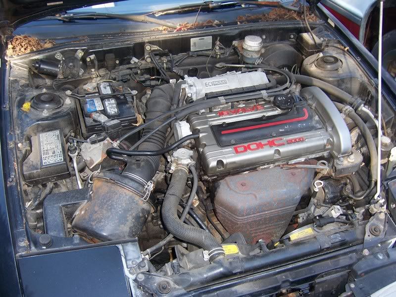

At the time of purchasing it had frozen brakes, a bad CV shaft, tires with belt seperation, and idle issue from sitting. So the basics to make it move on its own properly had to be done. Fresh Pads and rotors all the way around, new axle, some new tires (Dunlop Direzza 101) and a couple minor odds and end such as a fresh tank of gas, fuel filter, new plugs.
At this point she was running a bit better and I couls sit at a light and not stall out. Next came the preventative maintenance that every DSMer must go through at least once. All new timing components and waterpump. Then while I was at it I ordered up a cheap ebay strut bar and bought a lot engine degreaser.

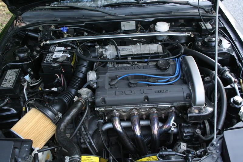

After a while I chilled out since the wife wanted to start saving and whatnot. So I did some cheap/free stuff. Got a new valve cover gasket, got rid of the cruise control, painted the valve cover. Oh also forgot to mention that at this time I purchased a 92 eclipse with a blown headgasket for $50. It was a manual with a black interior and that's all I wanted it for.
Donor:

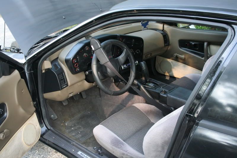

So the swap began and the hunt for some other odds and end to make the MTX swap complete. clutch, flywheel.
3 pedal Auto???
I think a clutch master cyl. goes there...
So the swap was completed within the course of 2 4 hour days. Did the pedal swap one day in 4 hours. Then the trans swap a couple days leater in 4 hours. Pretty simple and straight forward. So in the process I figured I liked the eclipses rear bumper more since it sat lower much like a lip kit would. So I swapped that over as well. Little hole drilling but that was about it. Also while doing the swap I decided to be a man and try no power steering. I figured the hell with it. I like a clean bay and that'd be one less thing to worry about. Same thought process went toward the AC. So off they went.
