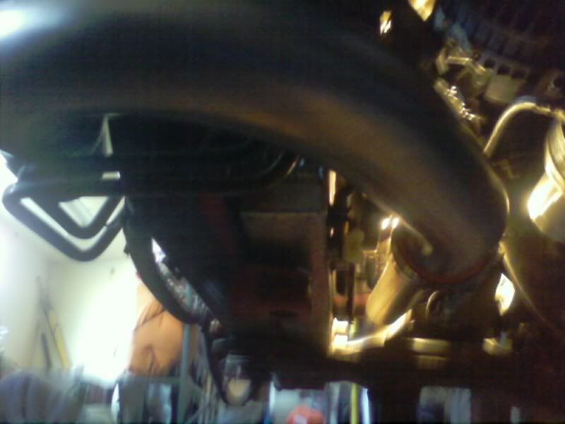

It is a U and does something like this:
And yea, the piping design is great for what it is. But the fact that it loops around like it does is very inefficient. I'll upgade the turbo eventually to something with more pep. Either I have a boost leak, or I'm going to have to put my MBC back on my car. Boost is falling off at higher RPM after installing the intercooler. The IC eliminated all of my previous knock entirely, but I believe it's choking my turbo. I'll probably have to turn the boost up with the MBC to compensate for the FMIC and larger piping.
