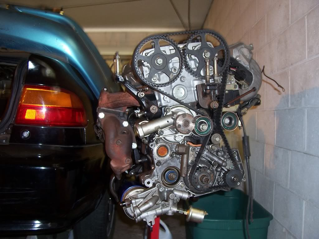

From the picture, you set the timing tensioner wrong, there is not enough tension on it, what are you referring to, (wasn't sure you pushed hard enough)? All you have to do is loosen the bolt on the tensioner pulley and turn the center until it is tight enough so that the pin in the tensioner will slide out and back in, it is a very simple process.

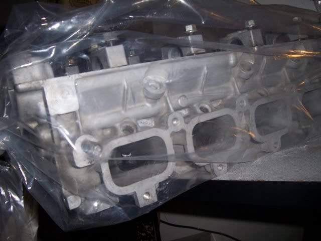

n5926g said:
If indeed this is the case,Id be calling the "shop" that reworked the head.
Those keepers can be a bitch,but....Damn!:tat:
I don't understand, i rebuild heads all the time, and you know exactly when they are in right, there is no way to mess this up.
#21 · (Edited)
I agree with what you are saying,but theres no telling what happened to the head after he got it back home....No offense intended:D
Actually it CAN be messed up,I took my head to a local shop,and supplied them with all new Valves/seals etc...Had them install them,and do a leak check...all was well,installed the head on the car,and one dead cylinder,0 compression.
I removed the head and found out that one of the new exhaust valves was about 1/16 too long...It wouldnt close.Now admittedly I should have looked each one over prior to delivering it to the shop,but they should have caught it also.
Looks like the tensioner is upside down.
