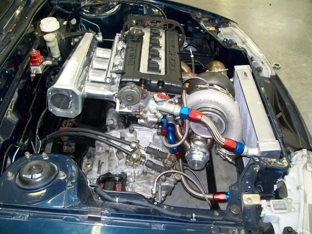

Next its onto building a motor, half filled 2 liter, Custom 9.5:1 Wiseco HDs, RNR aluminum rods, ARP L19 head studs
Lightly ported and oringed head, FP5r intake and fp11 exhaust cams, Kiggly springs, MLS head gasket
Ptt twin disc
Magnus Drag intake manifold (Thanks Marco!), Shearer fab exhaust manifold, gt4202R, twin tial gates, 3.5" exhaust (still a work in process)
3.5" DSS driveshaft
Solid front roll stop, New ball joints, sway bars, sway bar links, prothane bushings throughout
BR Coil on plug, Magnus fuel rail, Afco radiator, Aeromotive regulator
Stock tank back in, aeromotive proseries pump, dss stage 5 rear axles.

Here its almost mechanically done, fuel system is plumbed, boost controller installed, vac lines done. Still needed to remove some things to install the scattershield and install the harness after its completed, but then just safety equipment.
Took a few pics with the blackberry, will get real ones next week when the rest of this is completed.
