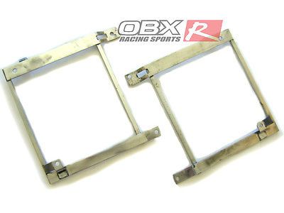

So, i purchased some basic seat brackets off ebay for about $55 from obx.
The bracket has four holes in the cross bars that are tapped to except the same bolts that the evo 9 seats use to attach the mounting brackets to the slides, however, the holes dont line up with the seat so i had to make some modifications
I then just bought a 3 ft section of steel angle stock, measured accordingly and cut 4 small brackets and then drilled all of them.

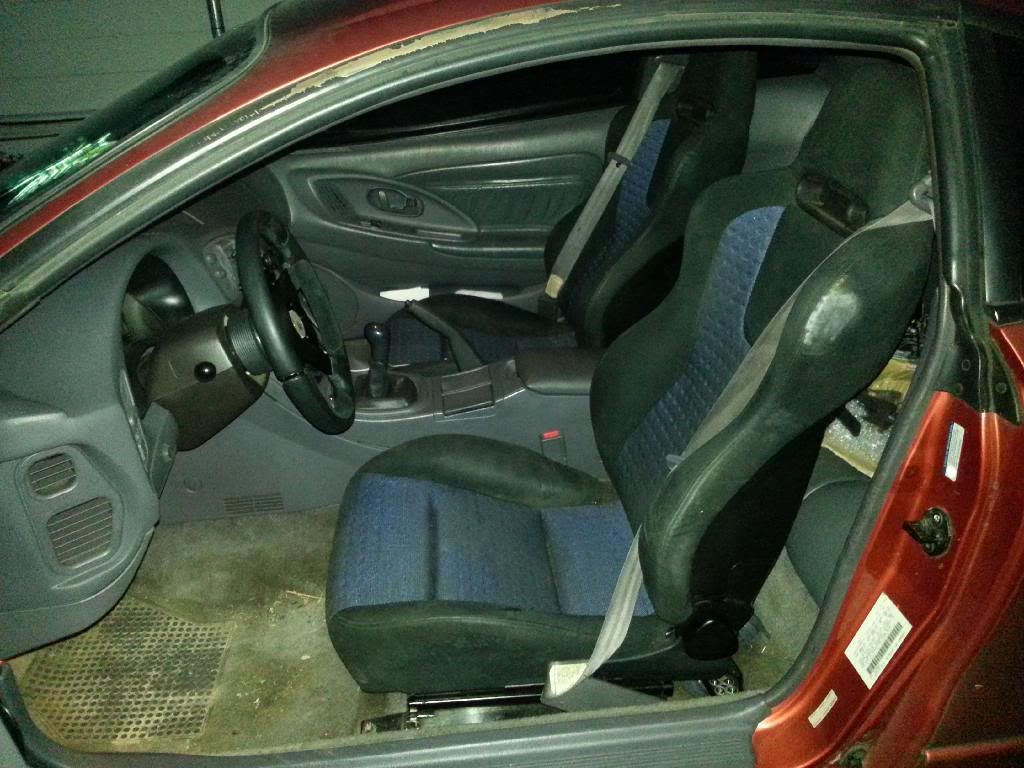

Here is the final result (sorry for the lack of during pics, i forgot how many people want to do this mod)
I just wanted to ahow that this could be done easily and fairly cheap. No welding needed and as for cutting, i just used a grinder with a cutting wheel on it.

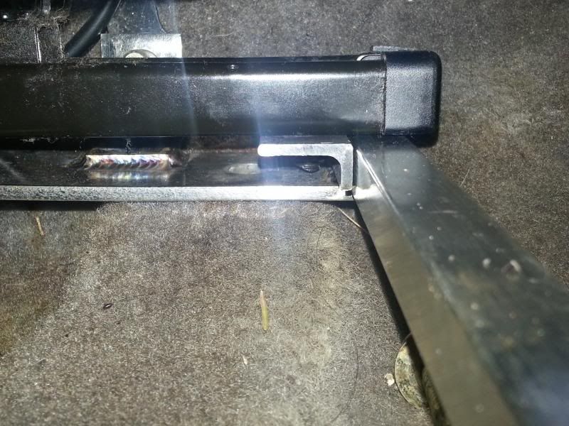

I tried to take some photos this morning for everyone
here is one side of the brackets i had to make
and a back side photo

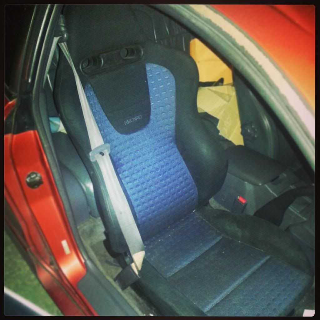

I might know where you can find a set. ;)
Call me a lucky bastard if you will, but my younger brother owns an evo 9 and swapped in all leather interior. These sat in my parents garage for about 2 years before my dad told him to take em or they were getting tossed, but he had no room to store them. So now they are stored in my car =)
Don't mean to be a smart ass but those are evo 8 recaros FYI. I have wanted to get my hands on a set of evo 9 seats for a long time, just can't seem to pull the trigger on 700 dollar seats in my 2g haha. Great info to have nonetheless!
You are correct! I was u der there making sure the bolts were still nice and tight (juat being safe) and they are marked evo 8. Odd that they were in an evo 9, but the car certainly wasnt stock when he got it. Sorry for the mistake on that.
