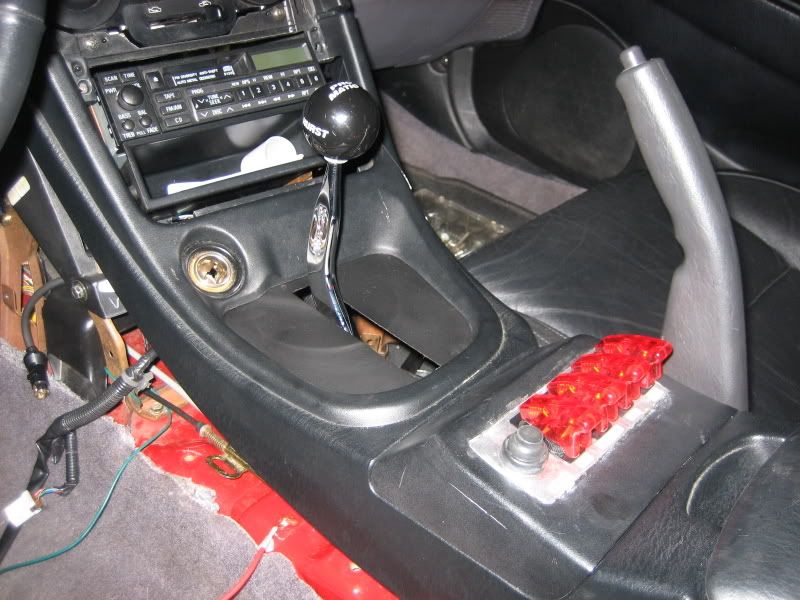

I got my hurst pro-matic 2 ratchet shifter installed tonight in my gsx. I bought it at Advance Auto parts for like 170 bucks. Every once in a while I do things that dont make sense lol.
Anyways, it fits very well with my center console and everything. The cable went in very well and I had to mess with the trans bracket a little but I got it to work. All I had to do to install it was remove the old shifter obviously, and then drill new mounting holes in the floor. Then I used some washers to get the shifter nice and level, and then secured it down with sheet metal screws.
The ratchet shifter will be very good to use along with the RMT shift box that I have installed in my car (quick manual shifts at full pressure). I am making a plate out of some sheet metal to cover up the big hole in the console, and I am going to mount my overdrive toggle switch on there.
Is anyone interested in a write-up of how to install this shifter? It is fairly easy, and takes about 2-3 hours total to put in. It definitely gives a better "feel" then the stock selector.
Here is a few pics and a vid of how the ratchet action works:
You LIFT the shifter from park to go into reverse, then pull back to neutral, then push DOWN to ratchet into drive, then ratchet back to 2nd, first, etc.

Alright guys, it is fully installed/tested. It works great! I will get some driving videos up very soon. I also made a little plate out of sheet metal to cover the gap in the center console. I painted it flat black to match the interior.
The install was fairly easy, I just had to drill some holes in the floor and use sheet metal screws to mount it, using washers to keep it level. Then I ran the cable through the firewall in the stock hole, and then used a vice and a really big wrench to bend the stock manual control lever on the transmission ( the thing the cable attaches too). From there, I used one of the brackets that came in the kit to hold the cable, and then got some lock nuts and washers to hold the cable to the manual control lever. Here is the finished product, let me know what you think!
