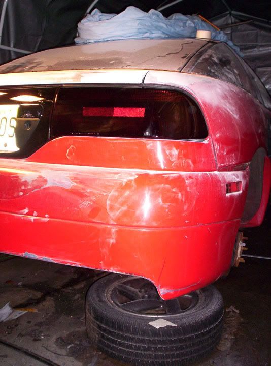

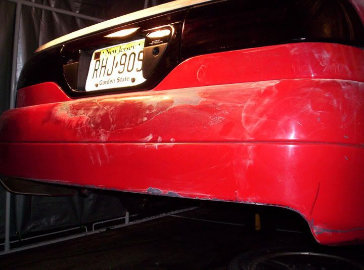

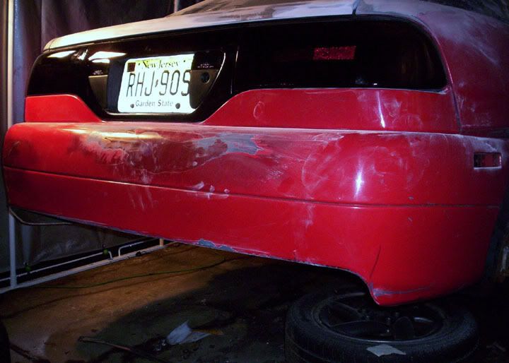

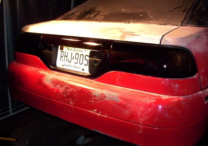

This is the start of my build up of my 92 talon, im currently in the process of getting the car stripped down and doing the body work and getting it painted. So far i removed the rear spoiler and filled in the holes for that, and the antenna, and put a laser hatch on.. i want my car to be different so it will have a 1ga front end with 1gb tsi sideskirts and tail lights, with no spoiler at all.. and the rear bumper cover was cut at the bottom for a diff look, the car will be painted very dark gunmetal (almost black) i already have the paint... just gotta get all the body work done... will have more pics up soon..

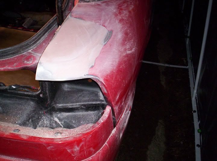

i completly gutted except for the dash. and cut the rear floor out and replaced it with some aluminum sheet metal which will serve as my fuel cell firewall as the fuel cell will be mounted in the stock location...
and finally riveted in, still have to seam seal the bottom

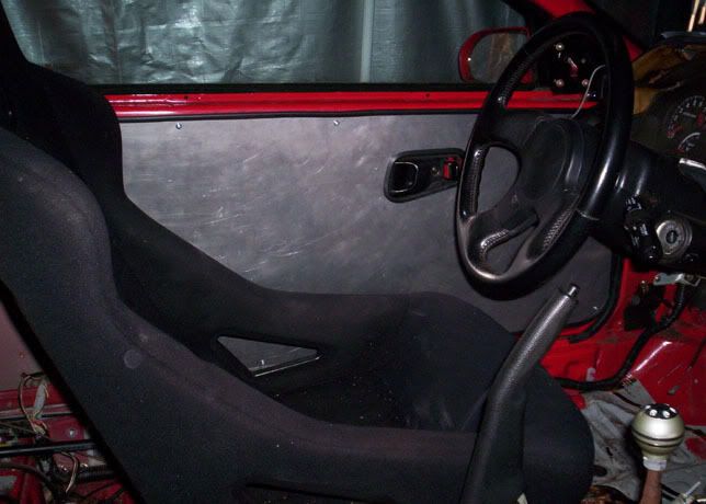

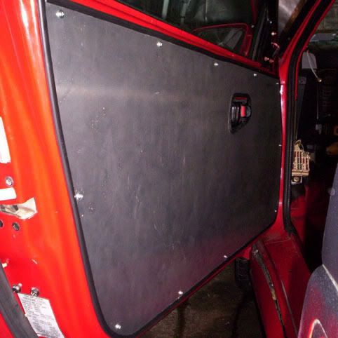

heres my aluminum door panels i made...
not yet riveted in, self tappers for now to hold it in place to see how they fit..as i will be using diffrent doors
door panel and sparco sprint seat, sitting in place for test fit, i made custom aluminum brackets for the seat, ill get some pics of that soon
projecTSI said:
Everything looks good, I like the door panels, I plan on doing the same thing, just wrapping it with black leather.
thats a pretty good idea, i was thinking on just painting them black, because there all scratched up, but i think if i just scuff the aluminum you wont notice all the scratches, leather would be sweeeeet tho

Looks good I like the rear bumper idea I also like the tail lights where did you get the black clear coat?:)
thanks :) , the tail lights are painted with VHT taillight tint paint i picked up at a local speed shop, i then cleared them with normal clear so they dont fade and last longer.
dsm614 said:
Me too.. haha
Where did you pick up the black trim that you put around the aluminum?
Looks like it would work for lexan also.
its door edge molding. you can get it at pep boys, i dont think it would work on lexan tho because lexan is to thick
