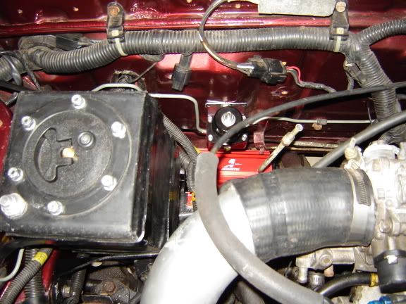

Engine compartment questions..Do I need the three solenoids on the firewall or just the fuel solenoid? I have no emissions on the car being race car only.
Will it work without that fuel solenoid or will it have problems starting hot?
Also couple minor things in engine compartment. What is that relay on firewall beside the silver fuel injector thing? Is it needed? And beside it is a tiny little cap on firewall.is that needed?
Not from weight point of view so much as just cleaning up things under the hood.
I don't have any of those relays. Removed them all and the a/c shit over there too.
The little cap thingy I believe is to cancel electric noise, and the relay thingy might be for the fuel pump? I don't remmeebr. For what it's worth, I still have all mine, but thier not on the firewall. located a little ways down to clean up the firewall.
