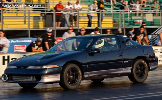

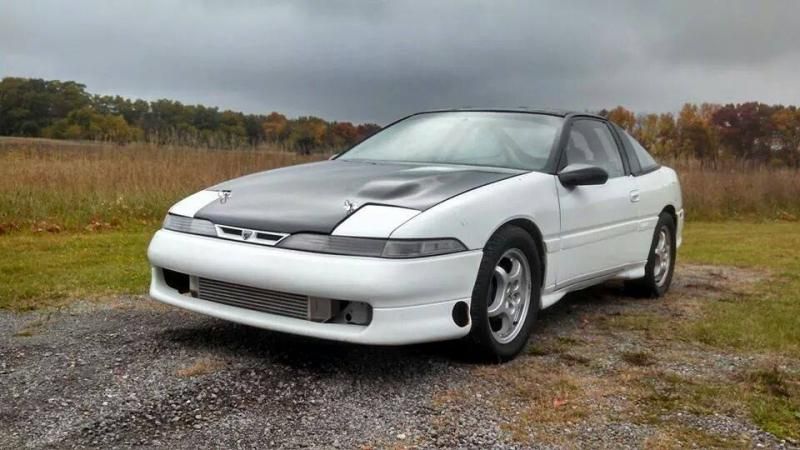

Figured I'd finally start a "build thread" here on DSMTalk. Especially after some showing interest in my drag racing updates. Thanks for your interest!
I'll start with the cars' current state and then give a little history.
1990 Eagle Talon TSI AWD
Current best ET 11.146 @ 118.17
Best mph 119.3
Race Weight: 2240 lbs (approx 2430 w/driver)
14b Turbo w/7cm hotside (ported compressor inlet and turbine housing)
Motor:
Stock top/bottom end 6 bolt motor (est. 200k mile bottom end)
HKS 264/272 cams
ARP headstuds - OEM headgasket
Bolt-ons:
2.25-2.5-3" intake pipe (custom 4" ram-air w/velocity stack)
2g maf
2g exhaust manifold (outlet ported, inlet untouched)
2.5" open dump O2 housing
3" Punishment Racing downpipe
ETS street/strip FMIC kit 2.5" piping
1g bov crushed
Extrude Honed 1g Intake Manifold
Old school Buschur MBC
91+ upgrades (fuel rail, cas, etc)
Drivetrain:
Anonymous built transmission (welded diff, double syncroes, the works)
ACT 2600 PP
ACT Unsprung 4 Puck
Stock flywheel
DSS 3" driveshaft
4 bolt rear end
Fuel:
Walbro 255lph
FIC 1050cc injectors
E85 Fuel
Stock FPR
Tuning:
ECM/DSMLink V2.5 (Self tuned)
91+ eprom ecu
Suspension:
Megan Racing Coilovers
Maximal Rear Camber arms
Anonymous rear toe eliminators
Anonymous Rear subframe bushings/Mustache brace bushings
15x7 Rota Slipstreams
M&H 24.5x8.5x15 slicks

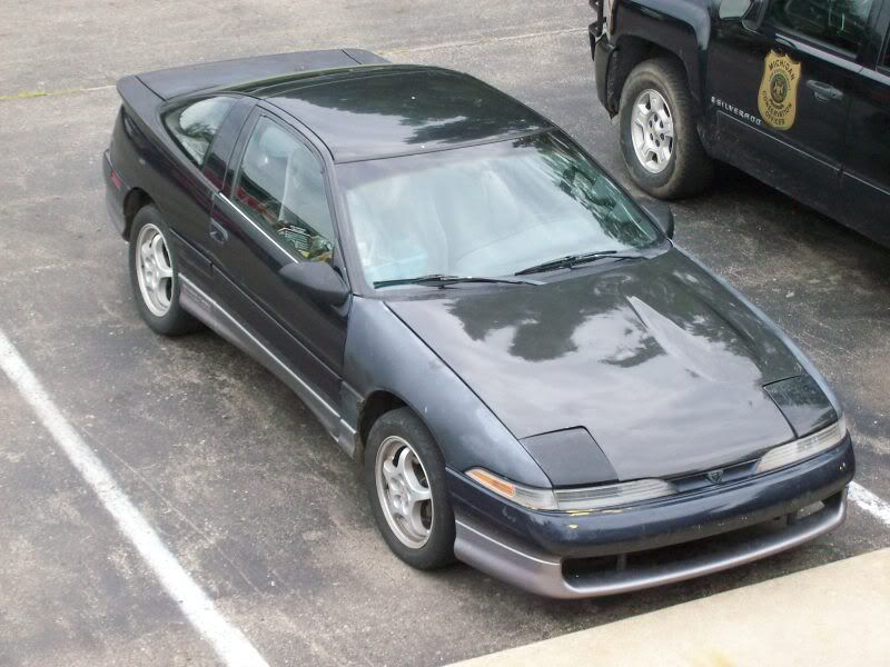

HISTORY:
Back in 2005 I followed threads from the likes of Phil Beers, Leon Reitman, and of course Joe Bucci's Project Goodwill. I was fascinated with the numbers those guys were pulling out of the stock 14b turbocharger and I wanted in on the action. Unfortunately my first project never saw the drag strip as it was parted so I could afford to go to school and start a career. The second attempt never did more then a 17 second pass with the wastegate arm popped off at the drag strip before it was parted to afford a new Daily driver. That was the end of 2008 and I still had the itch to build a quick 14b car. My ultimate goal was to be the quickest AWD 14b car, at the time that meant passing Leon Reitman who had run 11.642.
In early 2009 a friend called and advised that another friend had a 90 Talon he needed to get rid of...for free! Catch was it was just a shell, but alot of spare parts would be thrown in. Between spare parts I had left over, spare parts that were thrown in with the free shell, more donated parts from friends, and many small purchases I was able to piece it together into a running car by June of 2009. A special thanks goes out to DSMLoki here as it was assembled in his garage along with many of his spare parts!
It wasn't pretty and it didn't run well but it was a running driving dsm! I'll spare you all the old pictures but they are around if anyone wants to see them. Here's just one.
I ended up spinning a bearing in October 2009 during the car's maiden drag strip voyage. A mechanical oil gauge line broke and I lost oil pressure. Down went bottom end #1
2009's best pass was a 13.614 @ 93.37 mph (missed 4th gear)
I rebuilt the motor with some ITM 2g pistons and 1g rods w/arp bolts
2010 I ended up having some issues such as bent shift cables, 2 broken driveshafts, and snapping a 3 bolt axle. It was also when I added Link V2.5 and switched to Ethanol though.
Best run of 2010 was a 12.471 @ 112.33
At the end of 2010 after my last drag pass I added the ETS fmic and you'll notice from the pic above I also got a freebie Carbon Fiber hood from a buddy who switched from a 1ga to a 1gb.
For 2011 I added all the fun suspension stuff and really got working on removing weight. My goal was 11's in 2011.
Alas my best run ended up just short with a 12.050 @ 113.36 during the 2011 shootout. After the shootout I ended up over-shimming the wastegate and blew up cylinder #1 destroying the piston and putting the rod through the block.
My buddy who I'll deem my "sponsor" offered me a block he had laying in his garage. He had gotten it in return for something from a guy who claimed it had over 200,000 miles and it had jumped timing. There were some nice gouges in the pistons. A little smoothing out and I dumped it in the car. I ended up having some issues but after replacing 2 valves and guides in my head the motor was running good in enough in 2012 to drive it to the shootout. After the shootout I put a rough/safe tune on it and went out drag racing again.
I overly surprised myself and hit 11's on that first night with an 11.90!
I ended up setting a best street tire time of 11.812 @ 115.69
And then I was loaned a set of Hoosier QTP's to try out from Paul Volk.
11.541 @ 116.38!
I had finally surpassed Leon! But by that time the top AWD 14b time had been passed up 3 times! Dave Womer had ran 11.514, Phil Beers 11.49, and Nate Crisman 11.37.
So welcome to 2013! I purchased my own set of slicks and in May I had my first track visit. On my second pass I got the boot out of the drag strip for no roll bar, fire jacket, scatter shield, or harness.
11.300 @ 117.16
And then at the DSM/Evo/GTR shootout I ran the car's current best.

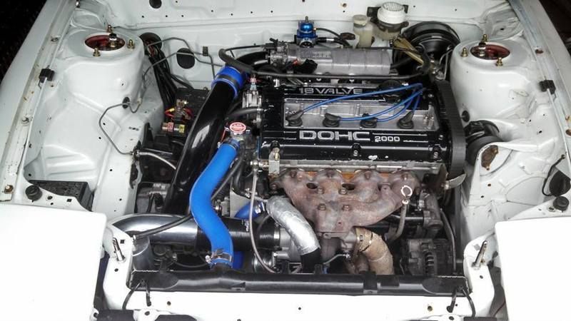

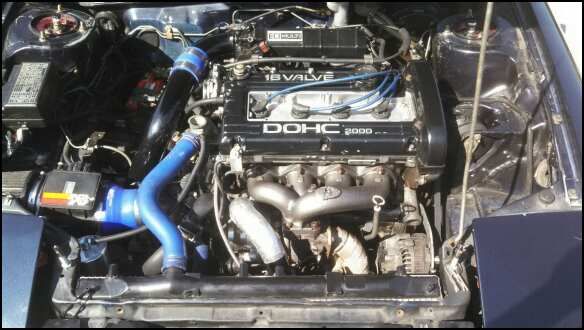

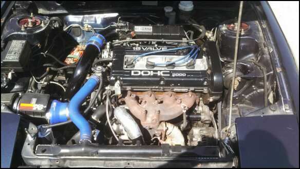

I've found some new motivation and it's time to get some work done. I wanted to add a second fan today but unfortunately I can't fit the second fan with my current LICP setup. So I put the new fan, which should be much better flowing then my old no name in. We'll see if it's enough to improve the cooling. If not I may be able to mount the old one as a pusher on the driver side.
I also mounted up the new FP Manifold a friend had sent to me to try out. I like the runner design better then the old 2g manifold, it definitely flows more with the larger runners, and it looks pretty nice in the engine bay too! I really like that the supplied gasket and the outlet are actually the same size as the ported inlet on my 7cm housing as the outlet and gasket on the 2g mani was smaller. Sorry for the crappy washed out cell pics.
I did not have a chance to drive the car, but I may get to that today.
Before:
After:

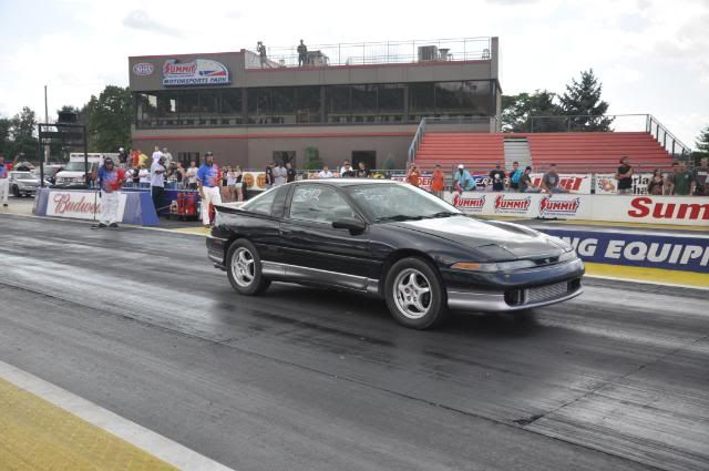

09/27/13 Track update!
Went out to Martin last night to try to learn some new things and more then likely finish up the season.
Changes to the car have been the FP manifold (on loan), new BR8ES plugs (the change to non-projected), stiffened up the suspension settings front and rear significantly, and added 1 degree of timing to the upper rpms and pulled 2% fuel across the board.
The weather was cool, 58-62* which was nice for some cooler intake temps I'm sure.
First pass the launch felt pretty weak and was with a 1.52 60'
Ran a 11.22 @ 120.42 - New mph best and broke the 120 barrier!
Second pass I tried dumping the clutch too fast and literally dumped it. Jackrabbit out of the hole, decided to let off after 3rd gear.
Third pass I knew it was the last one so I tried hard to get it closer to "right".
1.49 60' (good not great)
11.15 @ 120.87 - Backed up that 11.14 well and 2.5 mph faster then that run.
So no new best ET for the car, but at least I got some new mph out of it and learned a little bit. The stiffer suspension definitely helped, I just need to dial in my left foot more for next year.

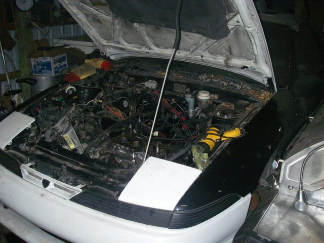

Hey! Well, technically the car has gone to the scrap heap! But, the spirit lives on. I purchased a new gsx shell with a 6 point rollbar so I can continue the quest.
The ol blue car went 11.14 last year at the shootout.
This is the new car/shell. Everything is basically the same minus new bushings, Link V3 w/speed density, the rollbar, and required safety equipment. Unfortunately I'm fighting an unknown issue. It seems to hit a rev limiter at around 6200 rpms every time, in gear or out. I've taken a break from it for the last month or two. I think it may be a grounding problem as I did go through and eliminate a lot of what I considered unneeded wiring. Might have removed the wrong wire or something.
#28 ·

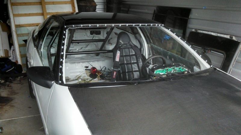

Wow, missed this post! I got this car in Pennsylvania from one Joe Pettit
Lately I've replaced the sunroof roof skin with my old non-sunroof skin and replaced the windshield with lexan. The car should come in at under 2400 with driver this year.
#32 ·
Awesome to see you still poking around with these things after Quitter McQuitQuit of Quittown Quitania aka DSM Loki sold all his stuff. :p
I'm running a 14B on my 2.4L setup for break in...in this heavy ass 2G I'll just be happy breaking into the 13's. :p
#34 ·
That poor shell....been there forever!
Some photo's to make this thread more interesting. I have a lightweight battery that goes in the bay, other than that this is about complete.
Here's the lexan windshield, I did finish a center support.
Engine bay
And it has been dubbed the S.U.B. - for Storage Unit Built
