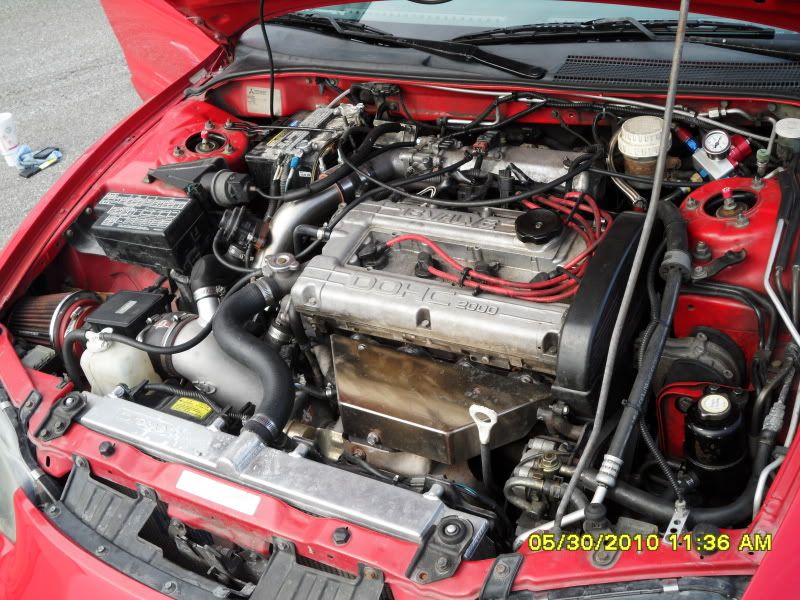

She fired up for the first time in several months with the "new" engine, turbo, and other goodies!
Only problem is...my buddy and I forgot to connect a particular oil pressure sensor, which is mechanical, so upon starting (for only 3-4 seconds tops) we had 2-3 quarts of oil on the ground to clean up. :p

I said I have some kinks to work out didn't I? :p The car wasn't even warmed up then, and I haven't worked out the kinks. The front o2 sensor is dead which is probably causing some of the problem. I have a new one to throw in.
You can see the MAP sensor just laying there by the battery. The vacuum line to the MAP sensor is like 3.5 feet long. I know that's causing some issues as well. The MAP and the FPR will be mounted and SD will be dialed in with the MAS before fully converting. I honestly don't fully understand how I'm going to do that seeing as I don't have the MDP sensor anymore. Is it needed for MAS dial in?
