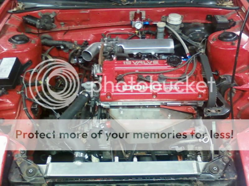

And an engine pic, to the eye it doesn't look like much work is needed...
