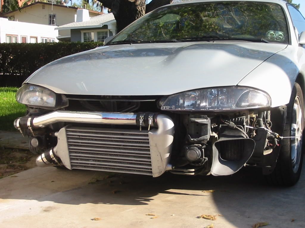

With the VRSF kit you only need to loop the PS cooler lines, and relocate your trans cooler to the stock SMIC location. You don't have to worry about it hitting the trans at all, and the best part is with the VRSF kit you can keep the stock fogs with no modifications.

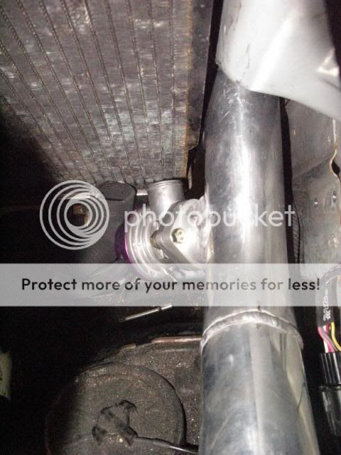

I ran a SSAC FMIC on my auto GST. All I did was move the tranny cooler to the side mount spot. I got rid of the hard lines and used rubber ones, no issues. I did have to get rid of the overfill tank :(
Checking tranny fluid became more of a chore. I also had to get creative with recirculating the BOV. I say get a long route piping if your an auto. It looks cleaner, and everything fits like it should.
I use the small Kinetic FMIC (same as SBR-no longer available)

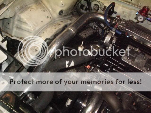

I also run the short route. You have to move the stock trans cooler. At first I put it in the SMIC location but that didn't work when I put in a CAI. I then moved it to the rad support in front of the rad on the pass. side.
You will also want to ditch that power steering cooling bar that runs in front of everything else. Just loop it with rubber hose.
I did have to bend the trans dip stick to a position that would not interfere with the IC pipes. When I did that, it started leaking fluid from the base of the tube where it enters the trans. Easy fix was to replace the o-ring, no more leaks.
The BOV was only an issue when I was still re-circing. The overflow is no problem at all. I still have the stock bottle in the stock location, just sits slightly higher and on top of the IC pipe.

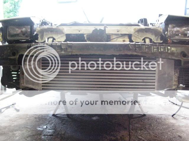

When you make the hole for the IC pipes in your rad support, try to keep it as low as possible. Then spray bomb the metal so it won't rust. It also helps to shave some of the ribbing of the rad itself on the outside edge. You can squeeze an extra 1/2"-1" of room that way.
