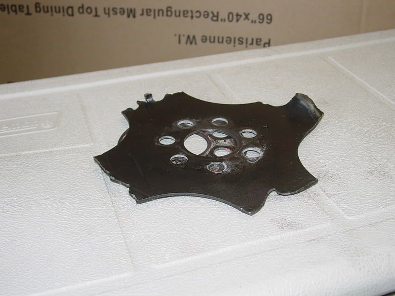

Running duel 7 bolt flexplates is your best option..Part # MD760092..I paid $37.00 for mine from the dealer...I have never heard of this setup failing....
Like said welding them is not necessary. It would probably cause it to crack anyway. But you can't just put 2 flex plates together. You also have to use 2 chime plates between engine and trans. With the one closes to the engine cut where the starter goes. This gives you proper clearance for the starter, and to prevent crank walk.
#33 ·
I run double flex plates and I had them welded together by drilling through one and filling the holes with weld, then grinding it flush again. I also used blue loctite when I installed it and it lasted almost 2 years before I heard a noise that turned out to be the bolts coming loose. I use the stock bolts as well, and have been told that 3 threads is as good as 20, it will all come down to the strength of the bolt after that. You need to add a second starter plate and cut one for the starter to sit in the right spot. I kept the other shims that go between the crank and the flex plates...at least one of them...can't remember now. Anyway, its good enough for the over 300 I put to the wheels.
