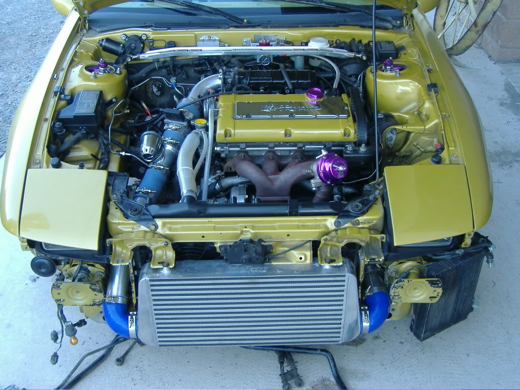

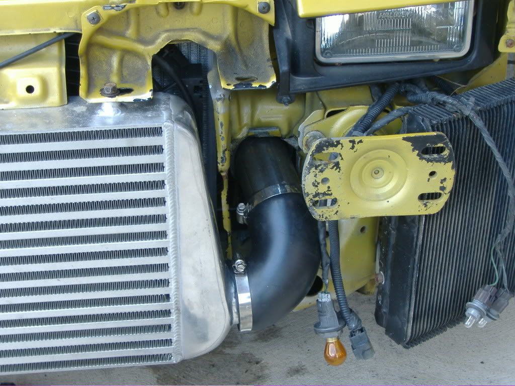

Also, if you have pictures of how these ICs look on a 1g that would be great to see.

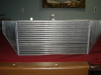

I have one of the 24x9x3 inch bar and plate ebay intercoolers with 2.5 inch inlet/outlet. Never had a leak. Looks great. I paid $140 for mine but it looks like prices have gone up since then. I must say that the intercooler you have picked out looks like some serious cheap quality. Shop around and find something better than that. Between the intercooler and pipes you will probably need to spend around $300. Good luck.
I got the same thing. The one I got is 24*10*3. It has very nice welds, and end tanks. It's bar and plate just like spearco cores. Mine came with 3' inlet, and outlet. I got for $150 with shipping from ebay. It's not exactly a bolt on, and you have to make all your own piping. But it works great I ran 26psi many times on pump gas and I'm very impreassed. Leaked tested not long ago, and no leaks. I tested a friends a DTV fab intercooler on my car before this one, and this one cools just as well IMO. I can run the same amount of boost and get the same airflow numbers. It may be cheap but it does require a lot of DIY fabrication.
