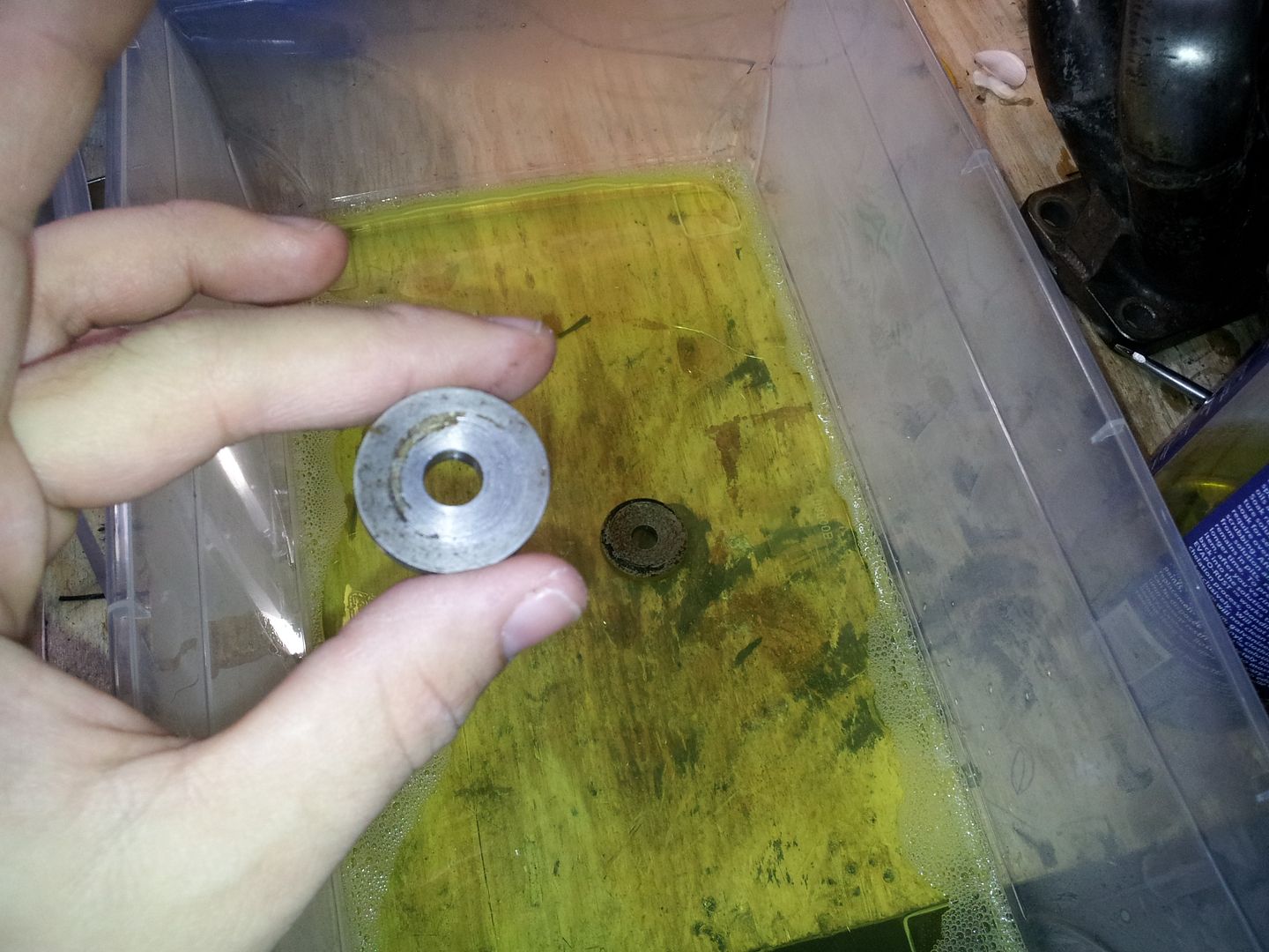

I filled a plastic storage bin with the 1L of it and dropped in two of the Symborski bushings. Here they are after about 30 minutes of soaking.

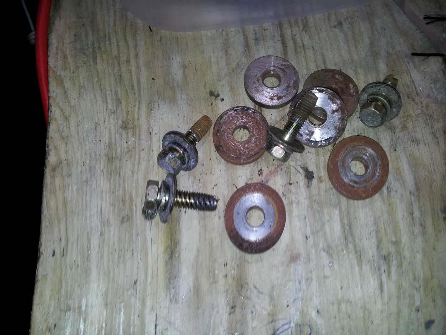

Here's the rest of the Symborski kit and some bolts. You can see what I was working with.

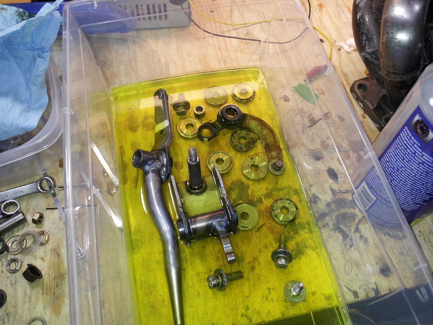

I then broke down the rest of the shifter and put it all into the solution except for the base plate.

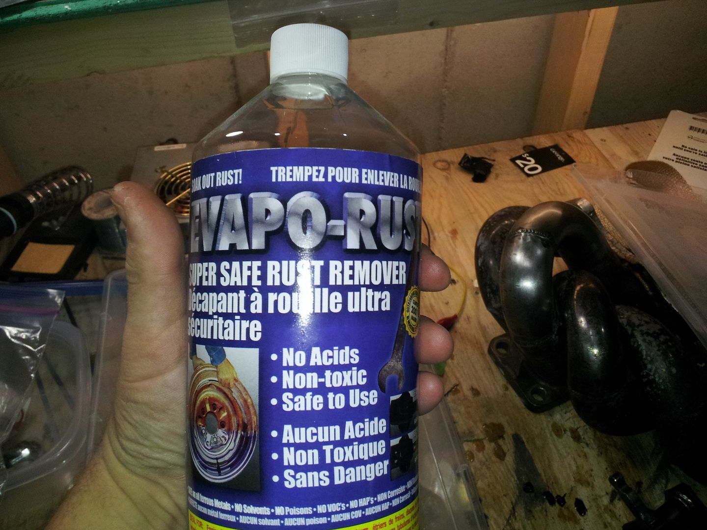

Picture of the bottle.
I have to say I'm pretty damn impressed with this stuff. It's mild enough that you don't need to wear a face mask or anything. Plus they claim it can get over 300lbs of rust removed. When it goes black it's no longer good and since it's mild it can be dumped down the sink according to the website (I would dispose of it properly though).
It can be bought at Harbor Freight in the states and Canadian Tire in Canada.

Here's all my shifter parts out, they look brand new.
My shifter base ready to go in.
In the Evapo-Rust.
I used a paper towel to get some Evapo-Rust on the places that weren't submerged. I then put some plastic wrap on top and put a lid on the tub. I'll check it tomorrow.
