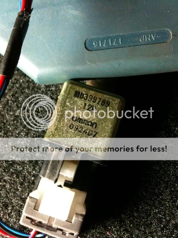

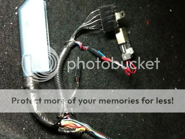

Hey my friend ! :) Here are the pictures we are talking about. Only ABS ECU is missing on the pictures. Can some one just unplug all these wires and chek if the car still running and what does not work when all these wires are unplug. You can find all this stuff under passenger feet :D
- ABS ECU harness
- 5 wires that looks like ground for ?
- Some kind of relay for ?
- And a little clip with 2 wires on it ...

Ok, I removed the whole ABS box and finalyl got the abs harness out as well.
I noticed only 3 wires actually go back to into the original harness, 1 black wire(ground) and 2 wires twisted together(white with red stripe & black with red stripe) The 1 black wire leading back into the combined grounds is for the headlight/turn signal(I can't remember) the other 2 twisted wires leading back are for the driver side abs plug, Which I simply just removed.
So all and all NOTHING was connected to anything, I hope I got it all right. I followed all the lines to the fuse box and they all lead back to an ABS fuse or relay. I simply removed the fuses and cut the wires from the fusebox. This allowed me to remove the entire abs harness without any problems.
I hope this helps out! I know my car is still not running but after sitting down and thinking about it it is pretty much self explanatory.
